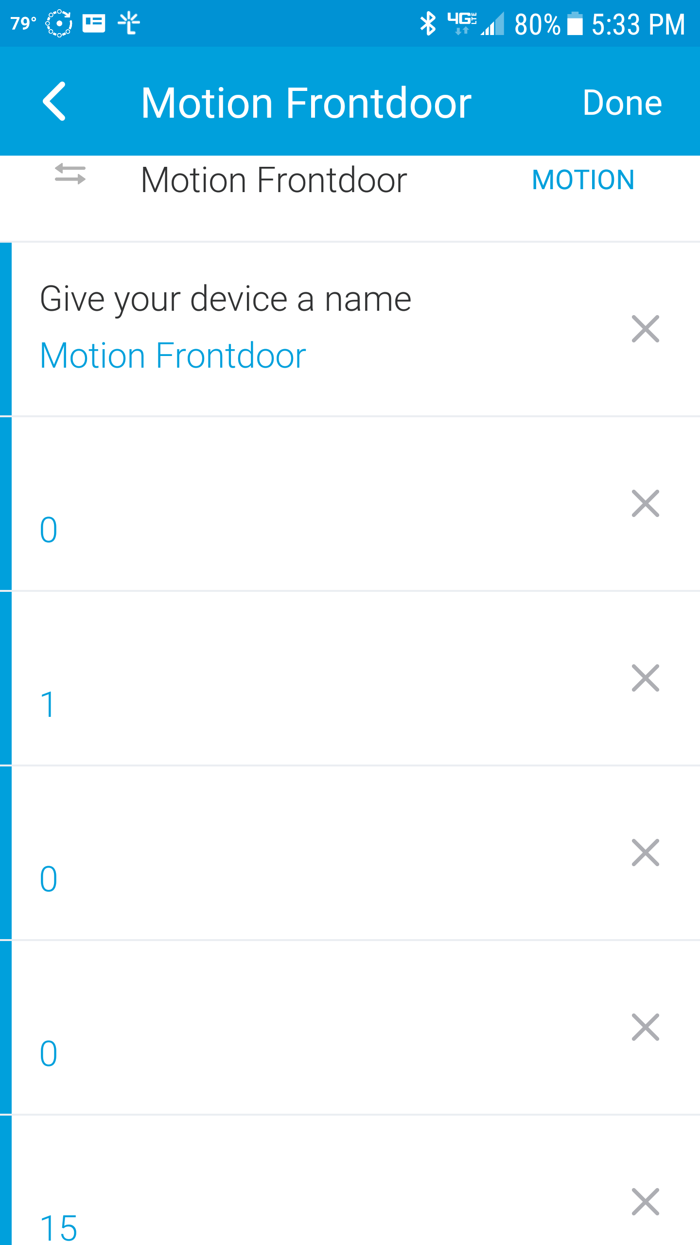

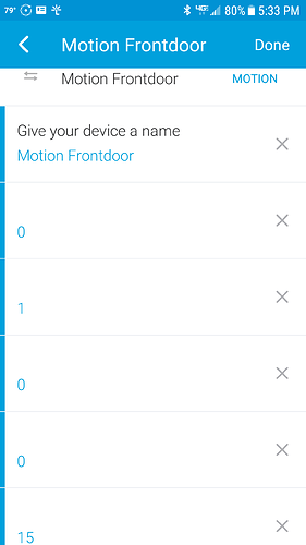

just got one of these, in the settings, none of the options have titles, is there a description of what these are somewhere? something I missed, or is it more of a guessing game? :slight_smile:
I see, you need to edit through the api site ‘my devices’ to get device option number
ended up going with the SC’s version as I have 3,2
but this is a snapshot of where to see the device option number in case someone new like me is later trying to figure it out
