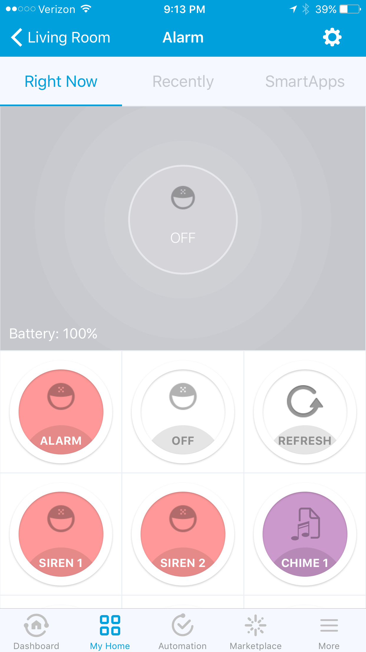

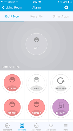

@krlaframboise I just made a small alteration to your DH you might want to consider. You are using the multiAttributeTile but only placing one attribute in it so far. I added Battery level by adding the following to the mutli-tile.
