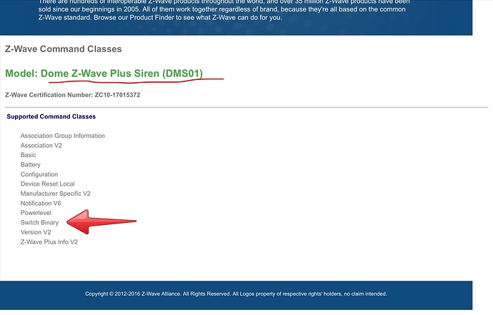

Under the zwave standard, if it accepts a âbasicâ command to turn on/off, itâs a Switch. That includes bulbs, wall switches, outlets, pocket sockets, micros, and, yes, sirens. It may do a lot of other things as well, but itâs a switch.
