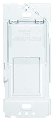

I used Caseta for this very purpose. And if you’re looking for one that you can just add to the wall, you could use the Lamp Module and pico remote combo. The pico can mount directly to the wall.
