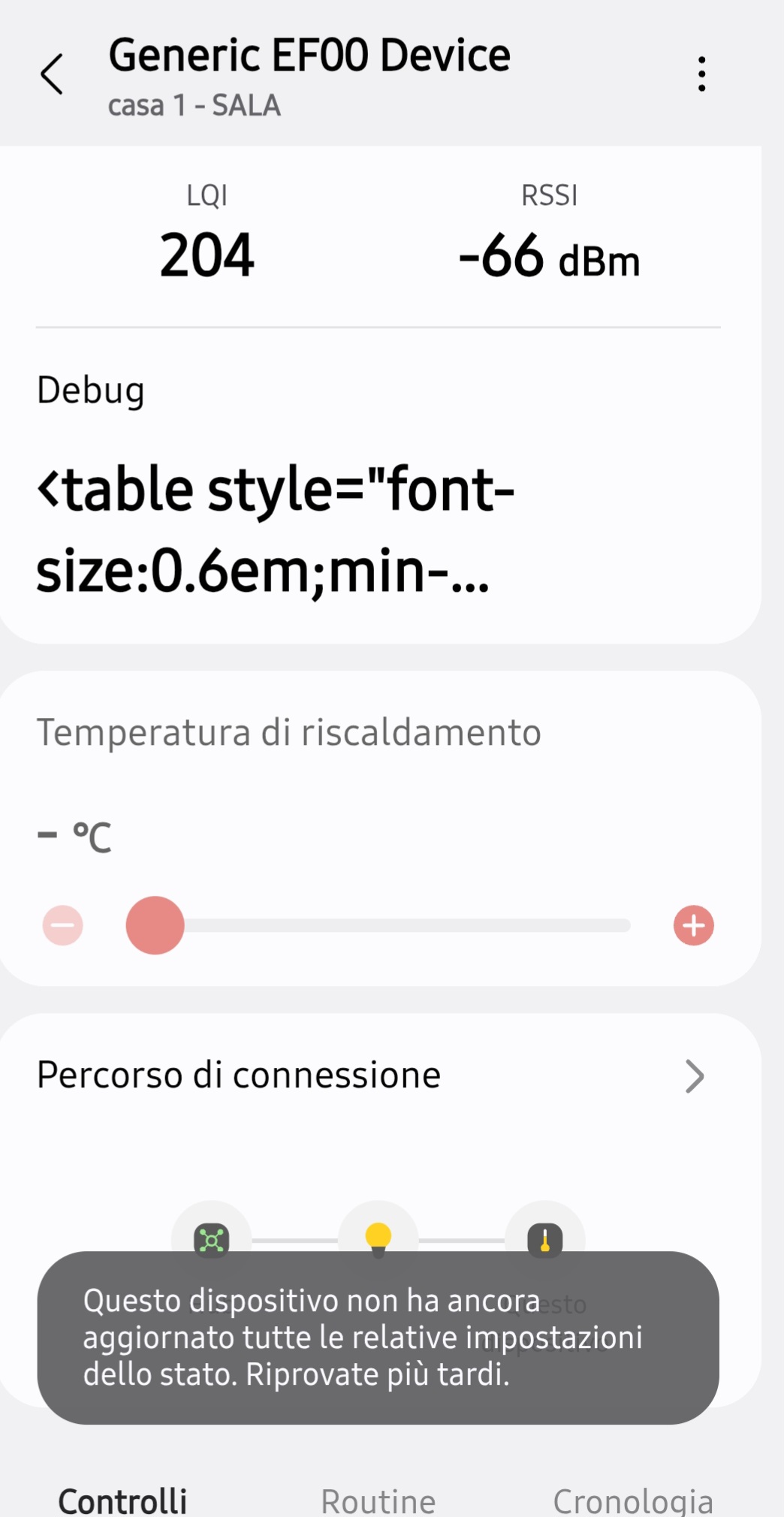

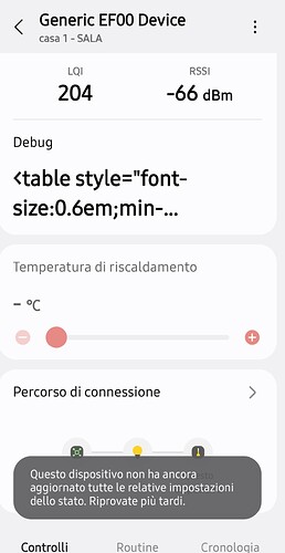

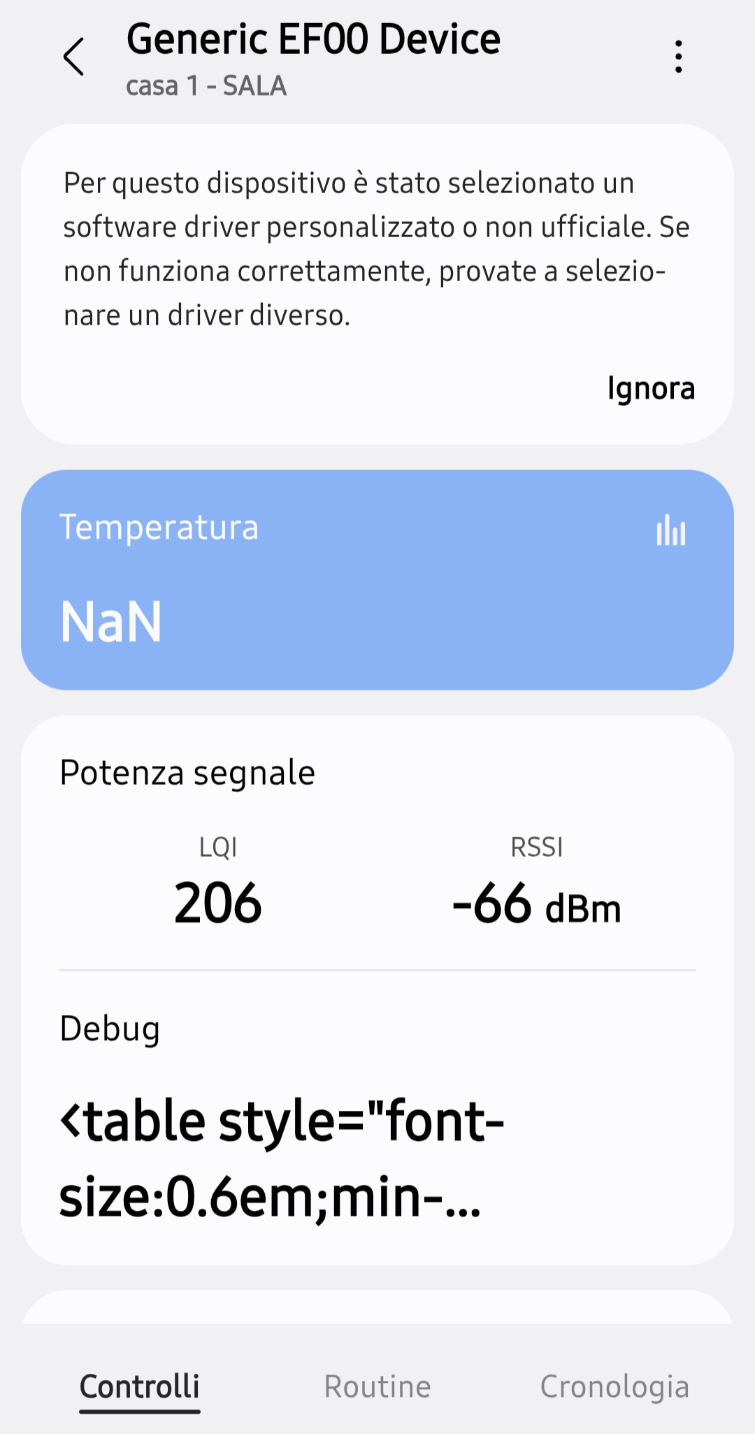

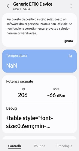

Hi @dotan_shai,
​I’ve updated the settings as you suggested for my _TZE204_zxkwaztm model. I set DP 16 for Heating Setpoint and DP 24 for Temperature Measurement using w35l3y’s ā€˜Zigbee EF00 Device’ driver (with a divisor of 10).
​However, I am still getting ā€˜NaN’. I also noticed that every time I open the device page, SmartThings shows this message at the bottom: ā€˜This device hasn’t updated all of its status settings yet. Try again later.’ The signal is very strong (LQI 206), but it seems the device is not receiving or accepting the DP configuration from the driver.
​Attached are the screenshots of my current configuration and the error message. Do you think this specific manufacturer ID needs a different setup or a specific Profile?
​Thank you for your patience!
