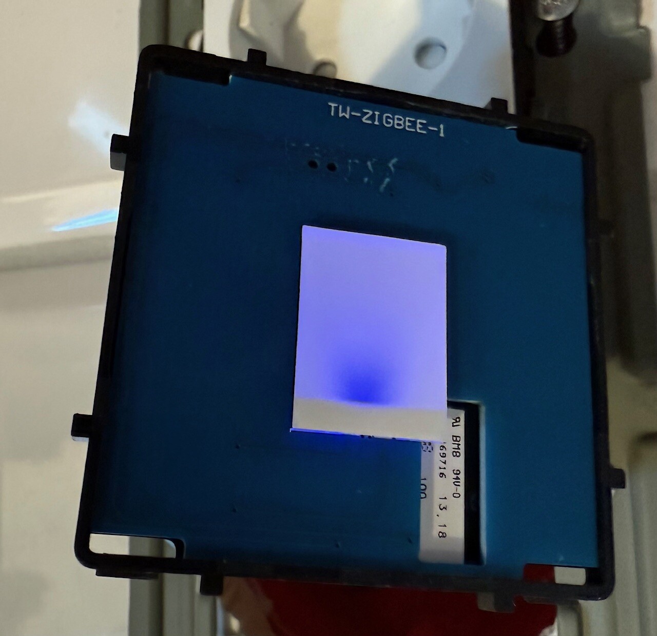

Hello,
I have a problem with the Zigbee switch _TZ3000_hafsqare. The device is correctly added to SmartThings and detects the Zigbee Switch Mc driver, but it cannot be controlled, and the data does not load. Is there any solution for this?
Add the “ZigBee Thing Mc” driver to your hub, and change you driver to that. It is located in the same place as ZigBee Switch Mc".
Then post a screenshot of the history. It may give us some clues.
Manufacturer: _TZ3000_hafsqare
Model: TS0011

I don’t see any EF00 clusters, so I would delete the device and repair the device.
Do you think the best option would be to return the button for a warranty claim?
Have you checked github? Is this device included in the driver?
If not then it is not at fault…
