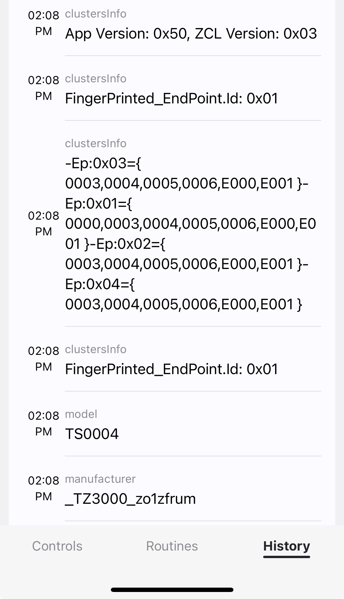

Hi @Mariano_Colmenarejo , would it be possible to add this switch to the Zigbee Multi Switch and Child MC driver?
Fingerprint: _TZ3000_zo1zfrum
Hi,
What model is?
At least Zigbee Switch Mc driver’s Profile Icon Plug also supports these same icons.
TS0004 and TS0006 please. Thank you!
I find it very strange that these two models have the same manufacturer number.
In order to add them correctly, I need as much information as possible for each device, manufacturer, model and if it is a multi-component, I need to know how many components the device has
This information can be easily obtained by installing the zigbee thing Mc driver, pairing each device with this driver and publishing the information from the details view and the event history, as can be seen in other requests posted by other users
example:
Apologies! Attaching the needed information.
The 2 switches we are looking to add is a 4 button and 6 button wall switch. The below photo is from the 4 button wall switch.
Thank you!
Hi,
I will wait for 6 gang data to add both at same time to driver
Since you do not send me the data of TS006, I have added TS004 and I will add the other one when I can.
you need uninstall device and reinstall it with this driver version installed in your hub
 Name         Zigbee Multi Switch and Child Mc
 Version      2024-12-14T14:54:42.232527661
- id: "_TZ3000_zo1zfrum/TS0004"
    deviceLabel: TS0004 Switch
    manufacturer: _TZ3000_zo1zfrum
    model: TS0004
    deviceProfileName: four-switch
