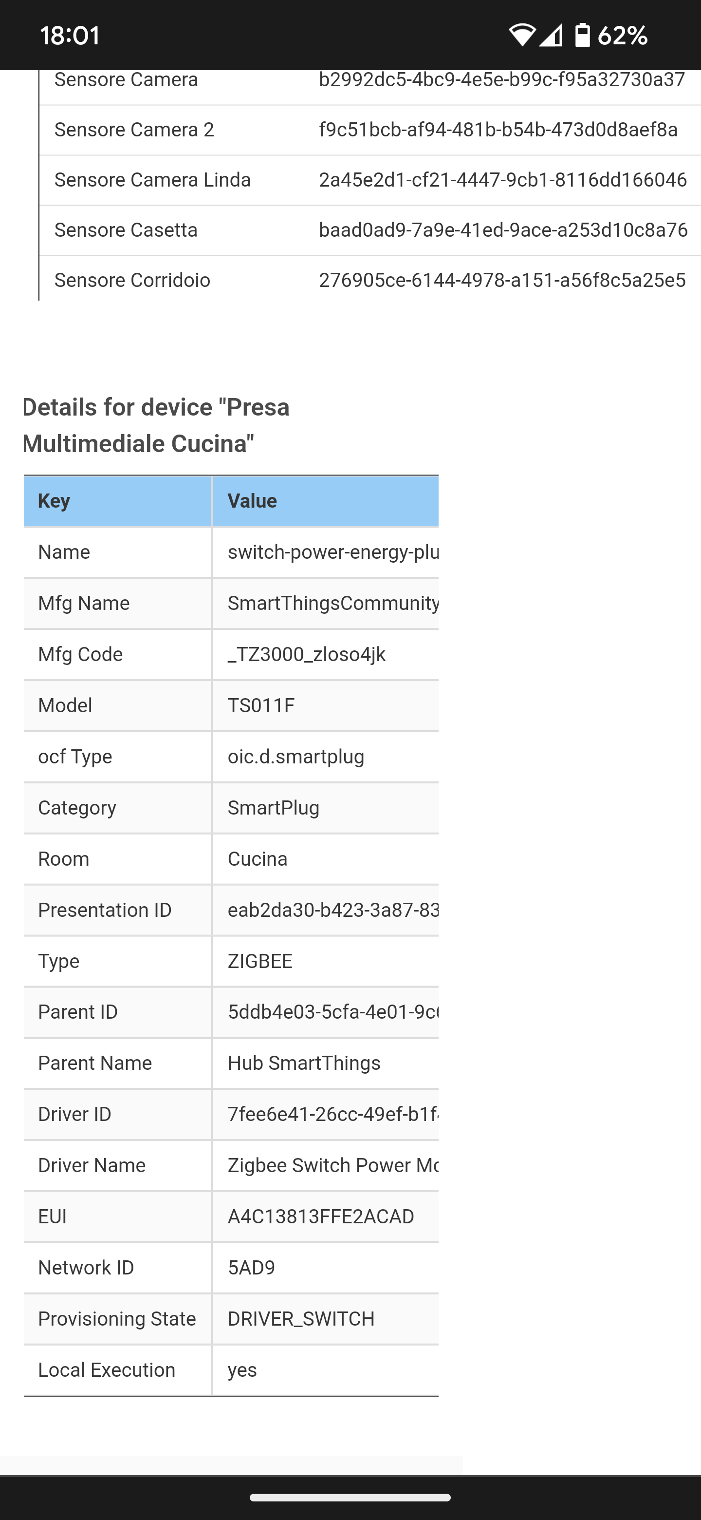

All my socket
Not work from 24 May.
I use this drive
Zigbee Switch Power Mc version 2.06.23
And i have firmware 48.3 (i think from 24 May because I’m in beta , but I’m not sure about the date of 48.3 arrive in my hub)
I try to change drive, reboot hub, bit not change
Hi @Diegocampy
Some users had problems with updating old version of the driver.
Reinstalling driver solves the problem. I think so!!, since when some users have a problem they ask desperately, get a possible solution and then they don’t say anything about whether it is solved or not. I don’t care, but it would make it useful for other users to know if that is the solution to the problem

Yes, after test I can confirm it.
I remove the drive from all my device, deleted the drive, and reinstall it, now work fine, thank you.
