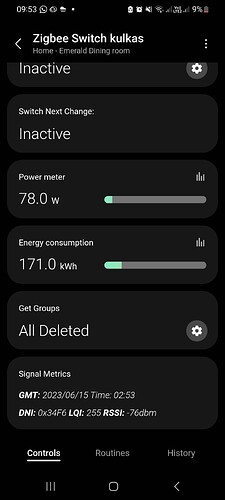

I also need help with this device,
It’s already added using your driver but when I check the accumumulative energy consumption seems incorrect (too high) since the fridge only consume 78w but the accumulative power already 171kwh within 48hours.
I use these settings, I put 1 because if I put 0 in the custom simple metering divisor and in custom electrical measure divisor it will not work
Any clue on the correct divisors parameter?
Thank you
Hi @ginanjar
Try with 100 in Electrical Measurement divisor.
Reset de energy with a riutine.
Added to this driver version

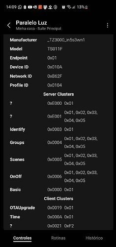

@Mariano_Colmenarejo pls add my fingerprint for multiswitch and child driver
 Name         Zigbee Multi Switch and Child Mc
 Version      2023-06-18T20:23:00.544739853
- id: "TS011F/_TZ3000_in5s3wn1"
    deviceLabel: TS011F Switch
    manufacturer: _TZ3000_in5s3wn1
    model: TS011F
    deviceProfileName: five-outlet
