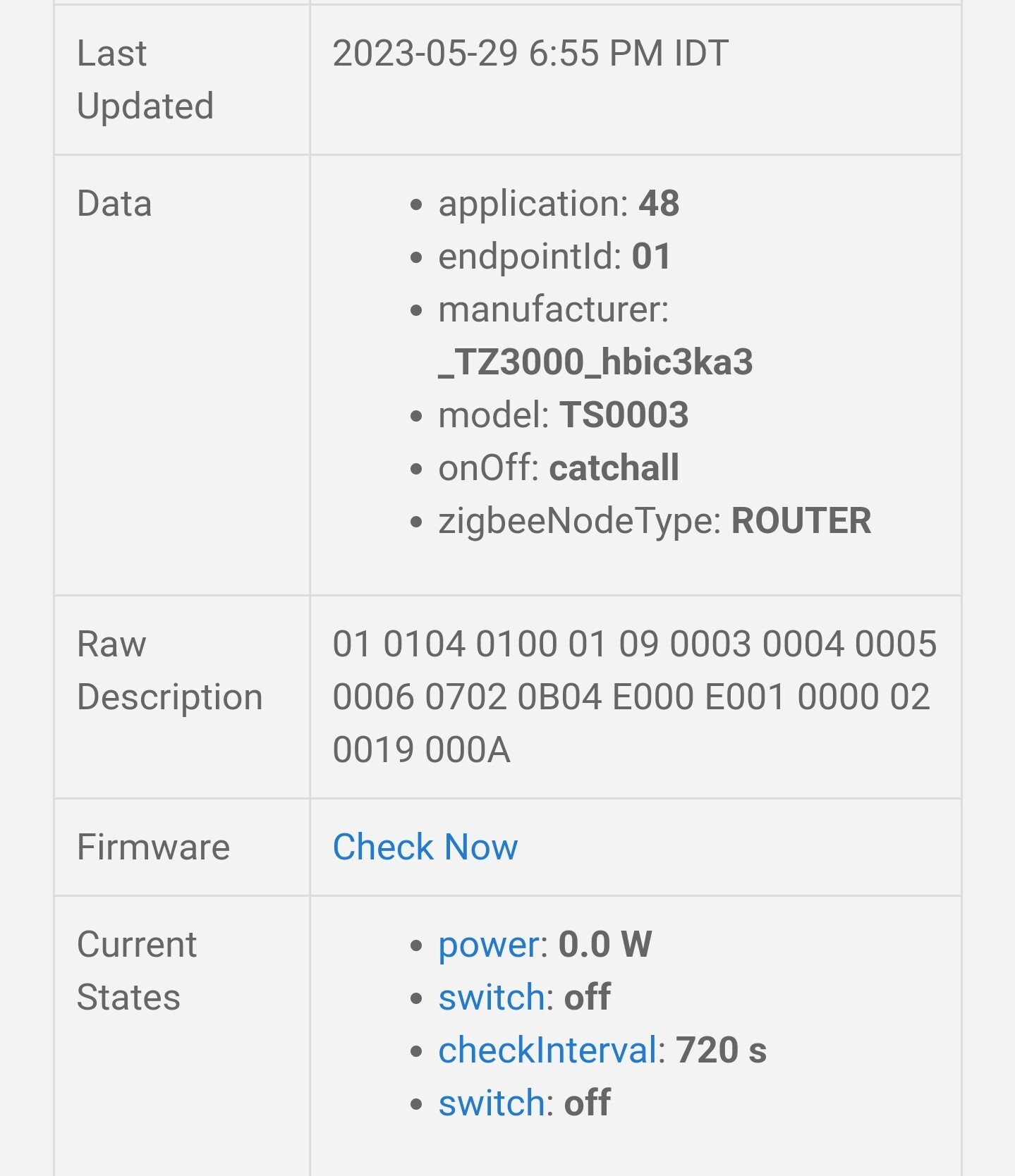

I bought this 3 gang switch.
Smartthings discovered it as “Zigbee Switch Power” so I can’t control the switches separately.
This type also isn’t an edge driver so when pressing the 3-dot menu I can’t change the “driver”.
Can you please help?
This is the info from IDE about the device:
[US $5.03 57%OFF | AUBESS ZigBee On-off 1/2/3/4-way Double-control Switch Remote Control Graffiti Intelligent Circuit Breaker Automation Module https://a.aliexpress.com/_ExVs3Sh](US $5.03 57%OFF | AUBESS ZigBee On-off 1/2/3/4-way Double-control Switch Remote Control Graffiti Intelligent Circuit Breaker Automation Module https://a.aliexpress.com/_ExVs3Sh)
Thanks!
Added to this driver version
 Name         Zigbee Multi Switch and Child Mc
 Version      2023-05-29T16:20:58.802129236
- id: "TS0003/_TZ3000_hbic3ka3"
    deviceLabel: TS0003 Switch
    manufacturer: _TZ3000_hbic3ka3
    model: TS0003
    deviceProfileName: three-switch
  • Install this new version of the driver in your hub from my shared channel.
  • If you already have another previous version of the driver installed and you have devices paired with other devices, then let it update automatically in a maximum of 12 hours.
  • Uninstall the device with the App
  • Add a new device in the app with the option search nearby.
  • When paired it will appear in the same room where you have the Hub
Thanks for your awesome work!
