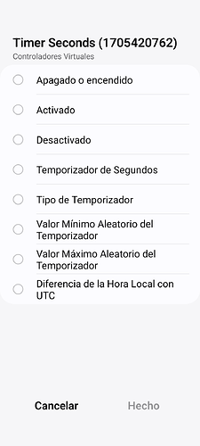

New version of the Aplicaciones Virtuales Mc driver
I have added a new virtual device, Timer of Seconds:
  • Programmable from 1 sec to 86400 sec, 1 day maximum
  • They have two types of timer:
    • Permanent value: the timer value is maintained until it is changed manually or with a routine.
  • Random Value: The timer value is calculated each time the timer starts between the minimum and maximum values established by the user in the corresponding custom capabilities. The allowed values are between 1 sec and 86400 sec.
  • The timer can be reset and restarted at any time with a custom capability manually or from a routine.
  • When you turn the switch to On or press reset, the timer starts.
  • When the timer starts, the date and time at which it will end and turn Off is displayed. For the local time to be correct you must enter the offset with the UTC time
  • When changing to Off the switch stops the timer.
  • It can be full controlled by routines
The driver has translations of capabilities to Spanish on all devices.
The new version will updated automatically in 12 hours max.
It may be necessary to clear the cache or close and open existing devices to view translations

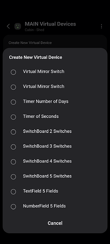

  1. Virtual Calendar is labeled Virtual Mirror
  1. For new installs it works fine. For existing locations where the driver updated I can not create new devices most of the time, but when I can create a device it is always a mirror switch regardless of the device chosen. I cleared the cache and force stopped the app multiple times

Hi Paul,
This is fixed, it was a translation problem, it takes a while to update, deleting the cache and closing and opening the device speeds up the process, but it will fix itself
Wait a while to create new devices, the presentations with the translations are updated at one speed and the code at another.
Don’t delete anything, it will fix itself
I have added two new capabilities to the new virtual device, Timer of Seconds:
This is the new function
  • Added a capability to choose how many loops you want to perform:
    • By default the value is 1 and works like a normal timer
    • The Value = 0 indicates that infinite loops will be performed, until the timer is stopped manually or with a routine setting the Timer switch to Off.
    • When each loop ends, the switch sets Off for 1 sec and returns to On. In this way, the true and false status is restored in the routines that use the timer as a trigger.
  • A capability has been added to show the loops already made, also accessible in automation conditions.
