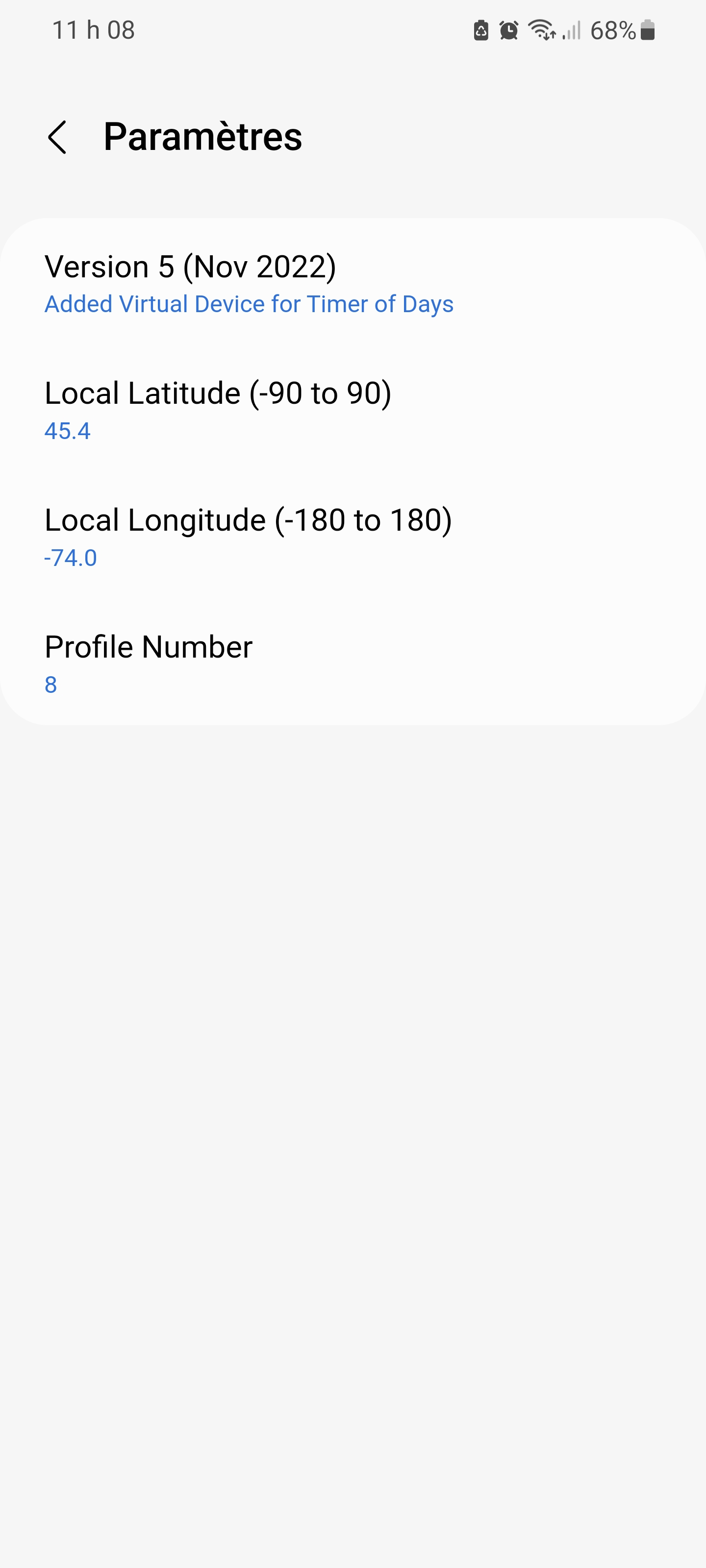

hello
i install and try the virtual calendar but the long and lat is not good, it’s look like it’s 4 hours too late but i can change it to be at the good time even if i had the good long and lat.
thank you for your help
Hi
I don’t quite understand what the specific problem is.
In preference settings you have to enter the latitude and longitude that you want to use, rounded to 1 decimal, since the preferences only allow 1 decimal.
Latitude: North is positive, South is negative
Longitude: East is positive, West is negative
You can get the coordinates with google maps for example
Then they have to enter the official offset of your local time from GMT in the details view.
Aplicaciones Virtuales Mc.
(SOS) is for to recover main virtual device if it is deleted accidentally
ok i will the other on.
here what i have;
When i install the calendar Default values
When i had the good longitude and latitude
Note : the time is 4 hrs too late and i can add a “-” négative sign in front of the offset.
thank you again (i’m a bigginer)
Hi,
If you use the iOs app, it may be a problem with the app, which has happened more times.
Write the value -4 in any text screen, copy the value -4 and paste it in Local Hour to UTC Offset in the details view
iM using a samsung phone but i will try it
