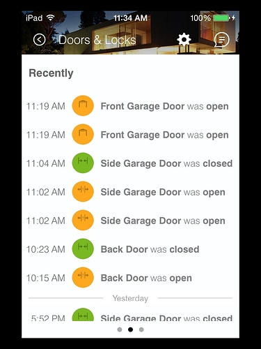

Last week I installed 4 of the Ecolink door/window sensors. Is it normal for them to duplicate open and closed messages sometimes?
I have 3 and havent experienced this
I haven’t seen that happen before. What does the IDE show in the event log for that device?
My Ecolink sensors seem to be 100% now, no duplicate open/closed messages. Maybe they just needed to sync up or maybe an extra power cycle of the hub or maybe Support fixed it!
