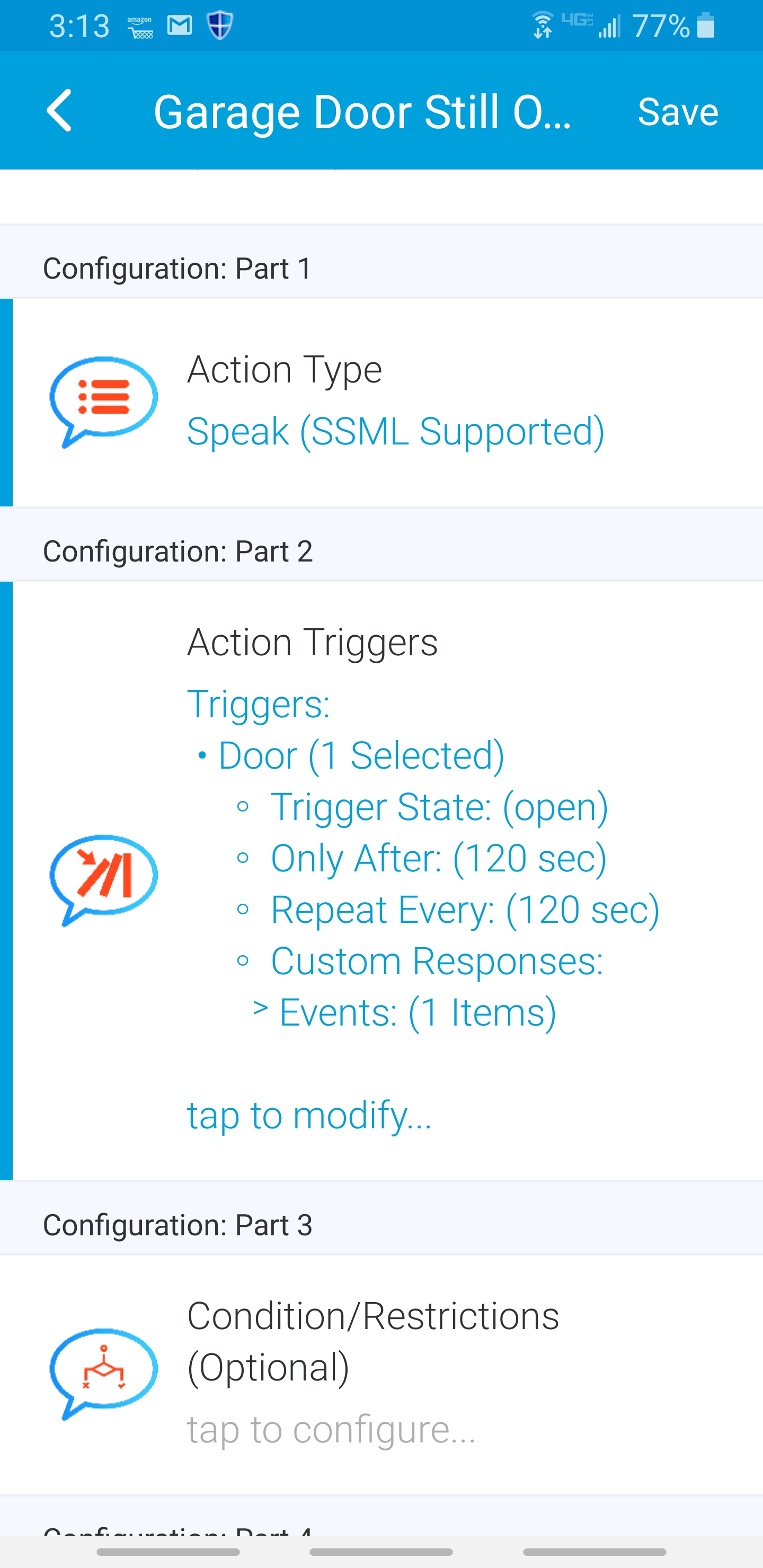

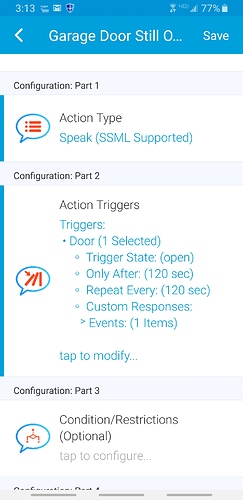

I’m trying to use an Echo Speaks action to alert when a garage door has been open for a period of time. Echo speaks is working fine with a separate simple notification that the door has been opened, but I can’t get it to work to notify if the door has been open for a period of time. I’m sure there is some logging but I’m not sure how to review to troubleshoot.

Yes, it speaks the action just fine. It just doesn’t fire after, in this case, 2 minutes.

I’ve tried this now as both a Garage Door and a Contact and neither works trapping a door opened for a period of time. Interestingly, I changed the contact in the Contact action to another sensor, one on a door that just reports open and closed, and it works as it should. With the garage door, I’m also able to get it to word to simply advise if the door has opened or shut.

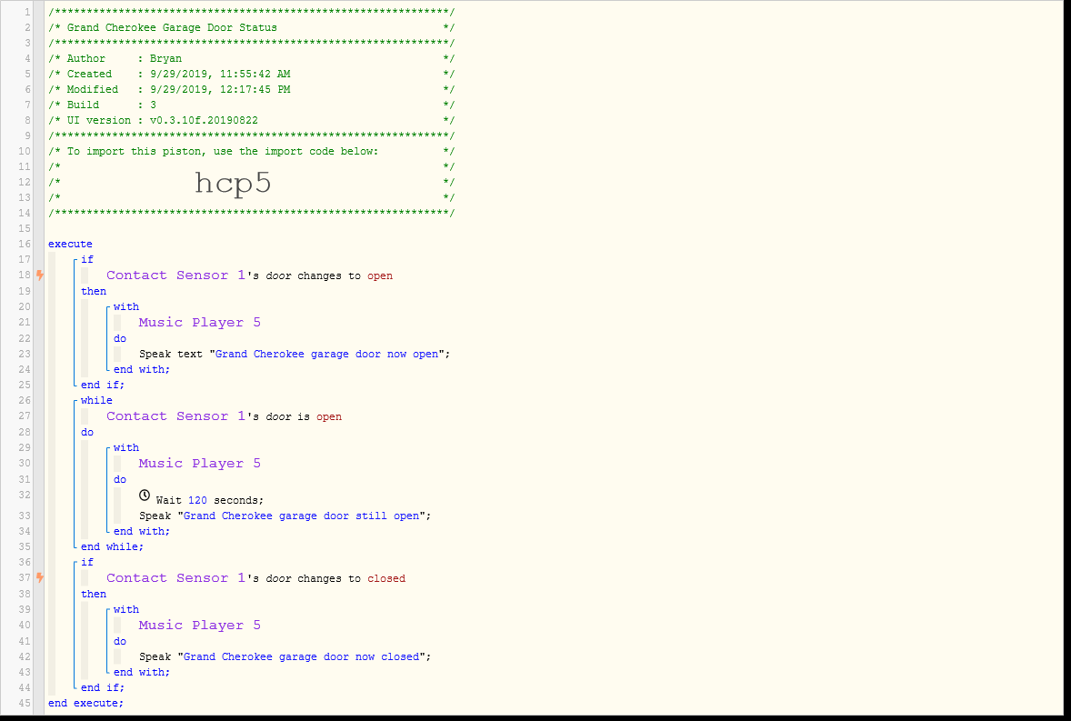

I’m beginning to believe that it is something unique to the GoControl Garage Door controller. I’m going to try it in webCore to see if I get different results.

Interestingly, it works fine in webCore.
I have two doors and tried writing one piston for both with variables, but the While loop running for one door would hose the execution of anything with the other door.

I can confirm the same issue with my Gocontrol Garage Door Opener. I tried every possible option in creating an Echo Speaks Action to “Speak” that a garage door was opening. No matter what the trigger, the “do” was never tripped. I created the action as a webCoRe Piston (“Garage Door’s door is opening”) and it works perfectly every time. I think I’ll continue to build all of my Echo Speaks related actions using webCoRe.
