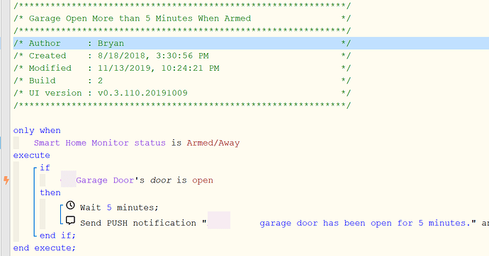

Here is a simple webCore piston. This one only runs when the SHM is armed (I haven’t fixed it for the new app), but you can leave that out.

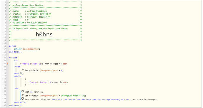

Here is another example:

+1 for a simple webcore piston
Thanks Bryan.

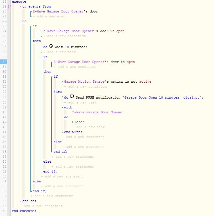

Would this work? It’s waiting for the status change of the door.
the push notification definitely will not work. You need to use "send push notification (msg) and store in messages.
You may want to post your piston on the webcore forum and ask for assistance with constructing the piston. You may run into other issues the current structure. There are a few users who enjoy helping others build their pistons. :slight_smile:
