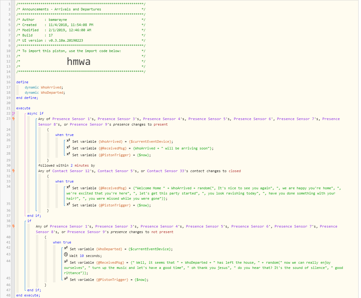

For announcements like doors, windows, arrivals, and SHM I use a couple of pistons. The first one is the “Speaker Control” piston. This one determines what rooms are active based on criteria and restrictions.
This piston is the one used for windows and doors. When one of the devices is activated, this controls the message that I want announced.
For arrivals and departures I use this, it has random messages.
Any piston that sends any kind of predetermined audio message goes through the Speaker Control Piston, unless I want it only on certain Echo Devices.
