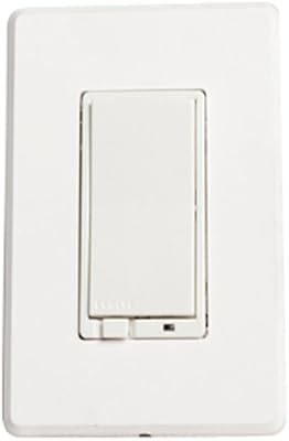

With the trend towards controllable bulbs, is there any “dumb” switches that ST controls? For example, I’m looking for a Z-Wave Decora wall switch that does not include the AC load relay. Can I assume I can take an existing Z-Wave switch and not connect the load?

I do something similar for virtual switched outlets. I have a GE Zwave switch that has no load, and it just controls turning on or off a zwave outlet that I have a lamp plugged into via two very simple SmartApps I created. I’m sure it can be done with one app, but my limited development skills kept me from doing more work on it.

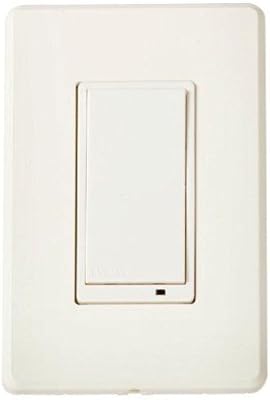

In addition, I’m looking for a Decora switch for a garage door. You helped me with Fortrezz MIMOlite interface which works fantastic. I would like a virtual Decora switch that would indicate garage door status (open/closed). I would think you could take an existing Z-Wave wall switch with a status LED and not use the load. I would assume there is some way to control the led to be the door closed status. Of course On/Off switch is not as natural as a push button for a garage door.
That’s a normal Zwave switch, and very suitable. Save yourself $10 and go to Lowes and pick up the GE switches in their Iris display. They are also Zwave devices. Lowes just relabled them to include the Iris logo. I have over 30 of the switches and outlets from Lowes, several smoke and co2 detectors, and a couple of the water sensors. Anything labeled with just the Iris logo will not work, only rebranded devices like the stuff I mentioned.
