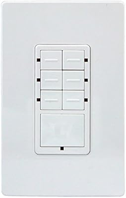

If you want something in-wall, you could try this:

Thanks for the suggestions. The minimote seems to have some potential. The Enerwave however is just a scene controller so it cannot do dimming. I wish someone made a wall switch, similar to the GE 45631 that would work like the minimote (since that, with some coding, can do dimming).
There are device handlers that make the Enerwave basically a mains powered and 7 button version of the minimote. You then choose what you want the 7 buttons to do. Check this out:

And as was mentioned, the Enerwave SC7 can also be used as a button controller for SmartThings. The issue with that one for some use cases is that it has to be wired into mains power, typically replacing a light switch. The other ones in the remotes topic are typically battery powered. If you were considering the GE 45631 you should definitely look at the Enerwave SC7.
