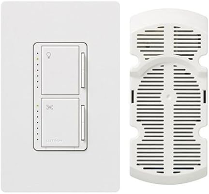

Since this topic is one of the first results for “fan and light switch” here is a modern solution to the original OP’s question.
Lutron MA-LFQHW-WH Maestro Fan Control and Dimmer Kit
The thread was also three years old. There are current FAQs on fan switches which do include the Lutron device.
Note that in order to make that device work with SmartThings you will have to also use a harmony home hub, it’s not part of the official SmartThings/Lutron integration since it doesn’t work with the Lutron SmartBridge.
Details in the FAQ ( this is a clickable link)
Weird that never came up in my searches. Thanks for letting me know it is not compatible with the lutron bridge, that seems silly that it wont work with their own hw. I guess Ill cancel that order and wait for a solution to come out. I didnt see anything similar to the Maestro in the other threads.
The maestro fan device is a very old device, it predates the smartbridge and the Lutron Caseta line and works in a somewhat different manner. The maestro line is not intended for House-wide automation, just for adding a remote in a single room. But since there is harmony hub compatibility, you can get integration that way, it’s just pretty clunky.
