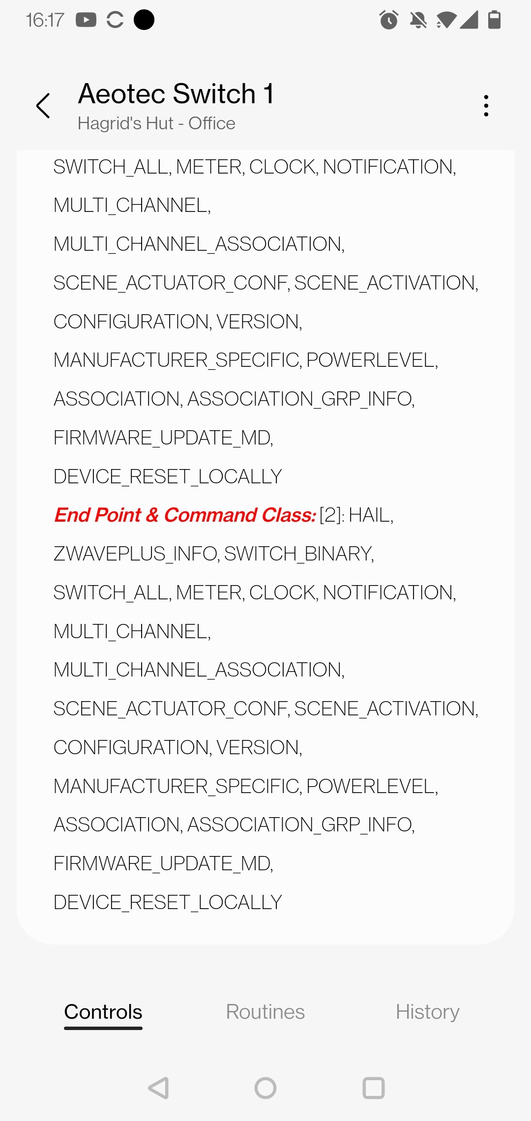

So…I gave up on that and swiched to a Aeotec Dual Nano switch.
This seems to have its own issues now. Have tried the new and old MC driver. It’s showing “Main” and “Switch1” but they both seem to control the same output.
It’s not showing 2 switches in the multi-tile either, so seems to not be picking up the endpoints properly?
When pressing the physical switch, I can switch the individual circuits just fine.
@Mark_McGee
Are you tried with stock driver Zwave Switch?
That didn’t come up as a driver option.
I could change on the IDE. Is it just a standard Zwave switch then - that will pick up the dual and energy reading?
You need install stock driver Z-Wave Switch stock driver from smartthing beta channel
ok, thanks
Ok I did that. Only shows one switch unfortunately
