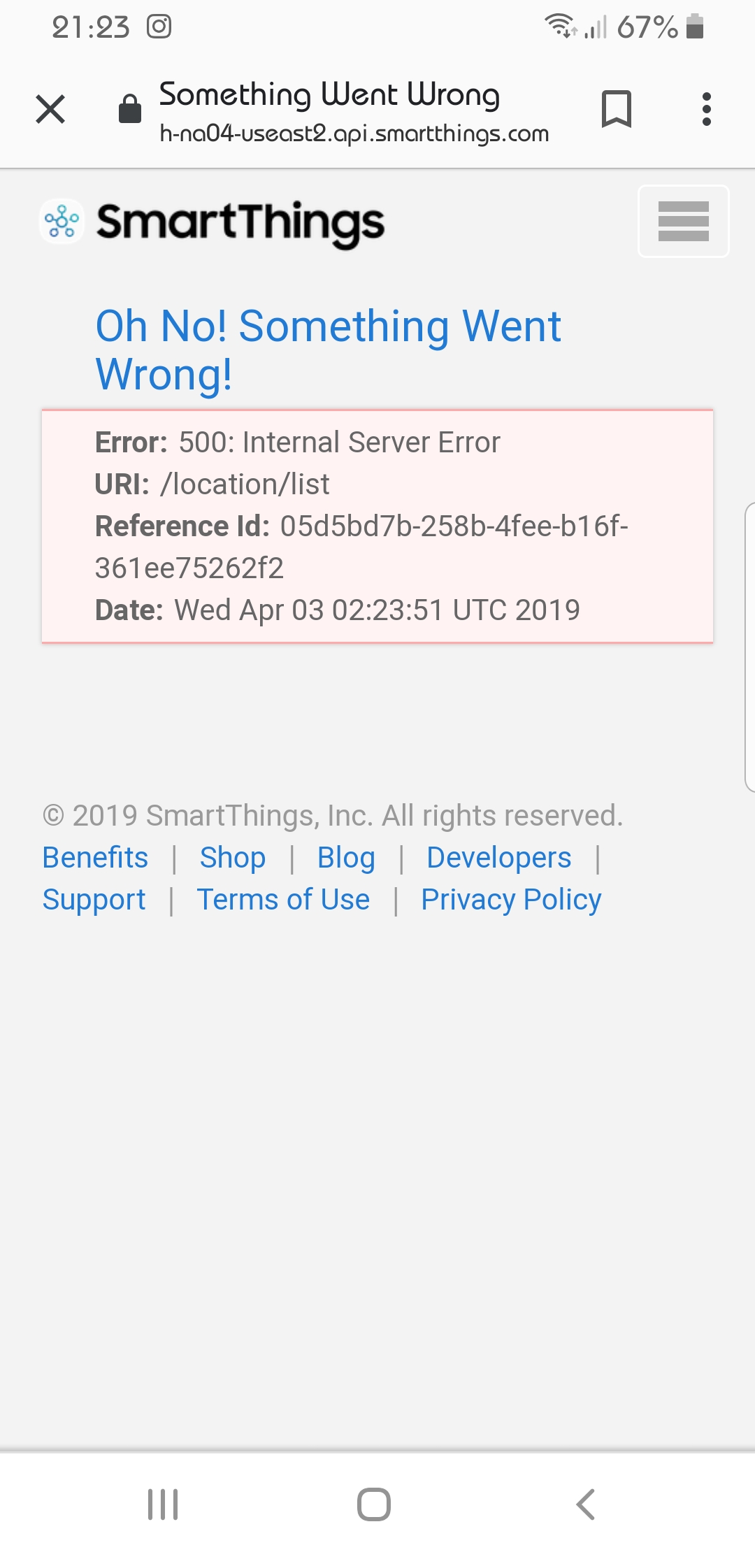

Recently I have paired a zxt120 IR blaster to ac control. I also set a custom device handler from github. When the device was set up with the new device handler the systems crashed and now I can’t access any device or hub control neither on the app or IDE. An error 500 shows up and have already tried to delete location and reset the hub but the error appears again and nothing happens.

Incognito on browser doesn’t solve the problem, it seems that the database is corrupted by an specific device.
Yes, corrupt device record for ZXT-120 Thermostat. This is the same issue as this Corrupt device is causing 500 Internal Server Error.
I fixed this one but if you or anyone else encounters it in the future, please contact support and ask them to escalate to someone who can delete the corrupt device record.
Fixed your issue too. You had a few outlet devices with a corrupt record.
