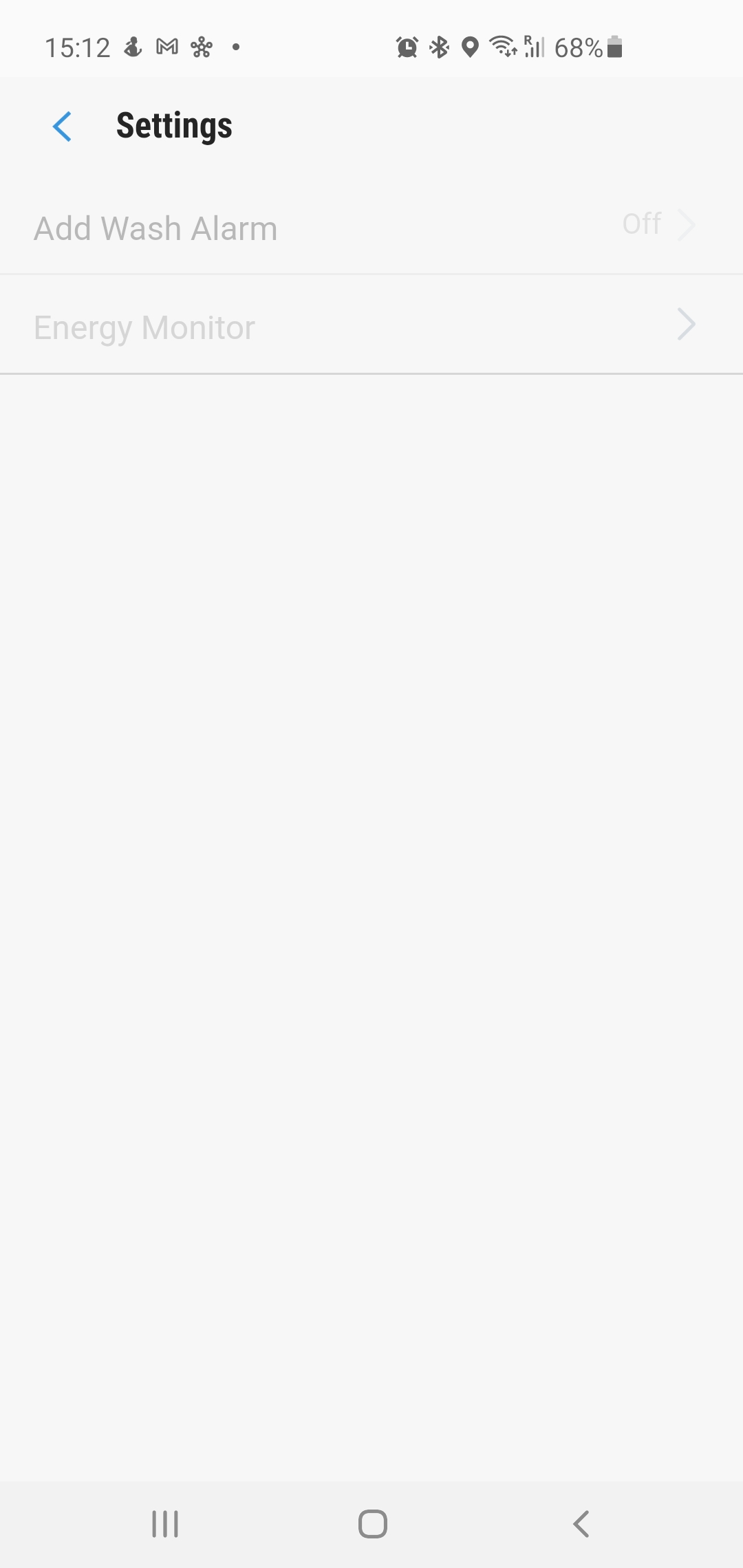

The washer is connected to the cloud and sends updates. On the dashboard tile it is visible how long is the actual program running, etc, but once the details view opened the washer is disconnected or powered off, no features are visible and cannot be controlled.
I cannot even get the energy usage of the washer as nothing updates there.
Could you please advise why the details view is not working at all for a cloud connected device?
