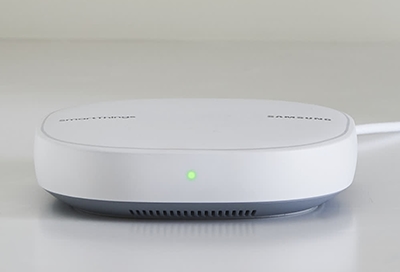

I noticed yesterday that my ST Connect Hub was not accessible from the Connect app on my iPhone. It said it was offline. Last time I used the app was a couple of days ago. I went over to the hub and it’s blinking red. I power-cycled it, and that didn’t help. I then reset it, which caused it to go through a long cycle of various LED colors- red, green blue, yellow, solid, blink… lather rinse and repeat. After about 5-7 min it resumed blinking red.
Oddly enough, local routines are working, but I’m frozen out of accessing it, so I cannot add some new devices.
Any ideas how to recover, or is my ST hub dead? I have a spare Connect Hub, but I’m loath to replace it because I have over 40 connected devices. I also have an old v1 hub, which I assume is or will be soon obsolete/unsupported. Any suggestions, with recovery of existing hub being the highest priority?

It’s fixed. I know how to install the hubs, but we had had a power surge by PGE a couple of days prior and apparently it damaged an ethernet router between my cable modem and the hub. I replaced that and was able to recover the hub, though not before I had completely reset it first. I had to re-pair all my devices and recreate all my automations.
