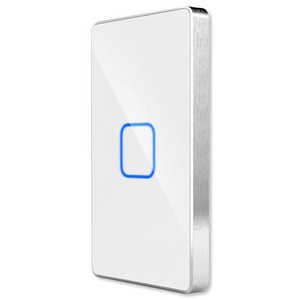

Aeotec has one right now that works with a wired relay switch, but they’ve announced one in a few months that will be wireless (battery operated). Capacitive touch.
This is the current model (you have to also buy the micro relay). Wireless is the same form factor, choice of white or black.
These also work with the aeon dimmer modules.
I have one of these in a spare bedroom, couldn’t do the full house due to the single gang limitation.
FYI, Aeon’s pictures are not current production, these are not glass and brushed aluminum as the pictures would suggest.
They are chromed plastic, but they are also only $14 bucks…
The Aeotec newsletter has said the second generation due out later this year will be the glass/aluminum and will come in multiple formats, including multigang, but we’ll have to see what really arrives to market.

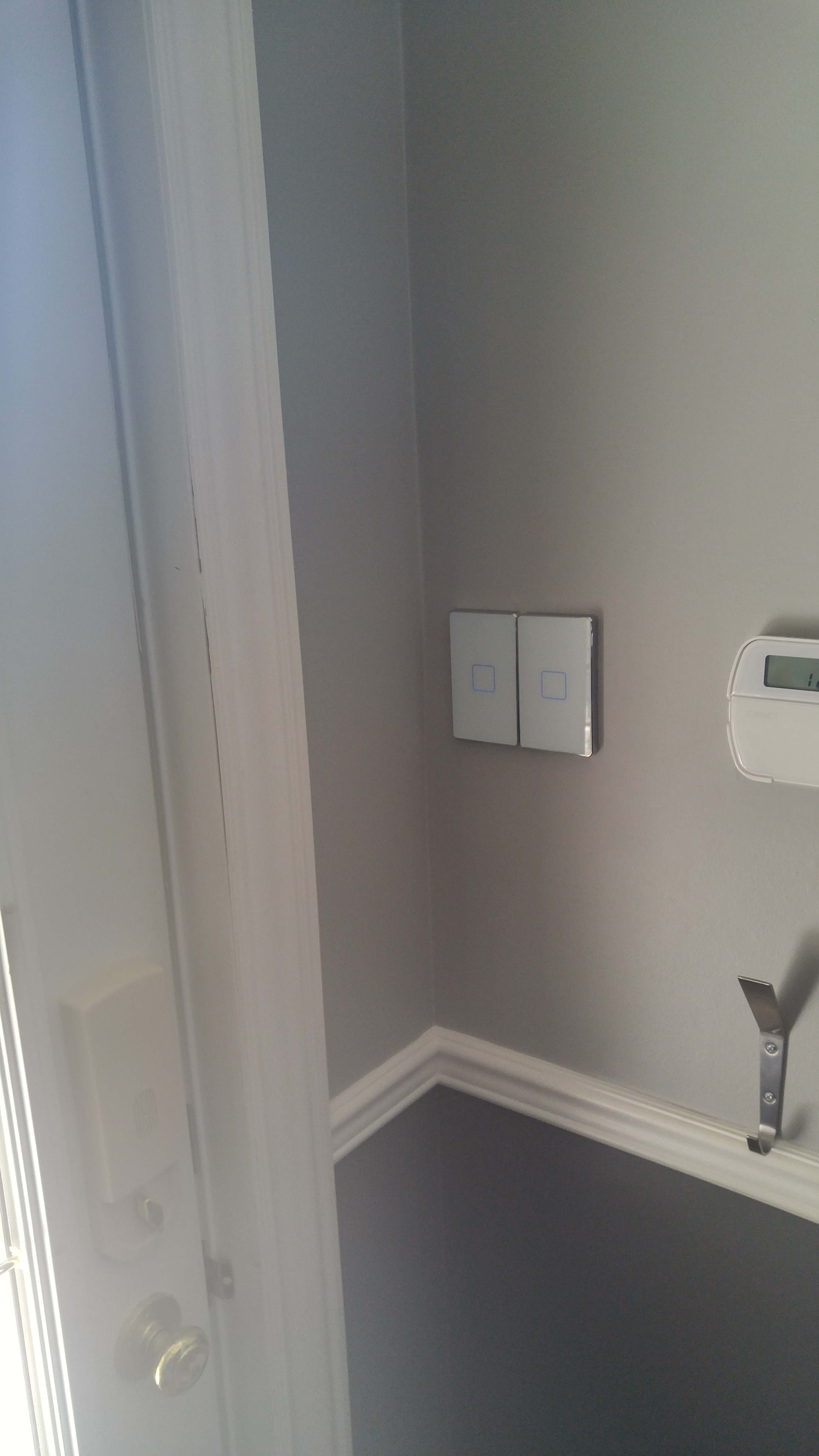

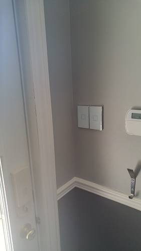

I have built a 2 gangs for aeon’s panel. It uses single gang flush mount and are soldered with bolts and washers to the exact gap.
