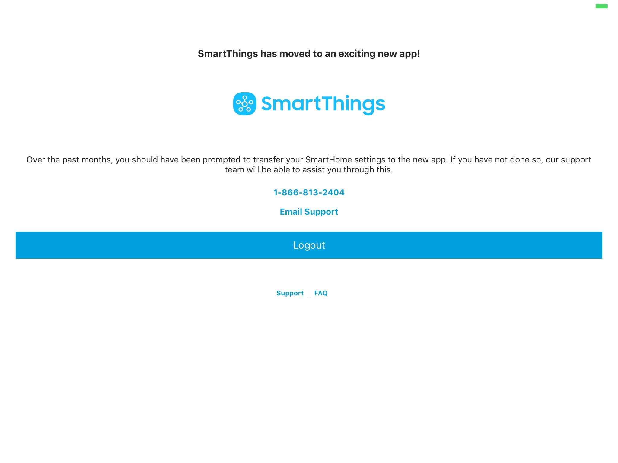

the final release for the classic app
Be warned: all it does is prompt you to logout
If you have NOT migrated yet, it gives you more options…but be warned, it was intentionally designed to only support migration, not ongoing use.
