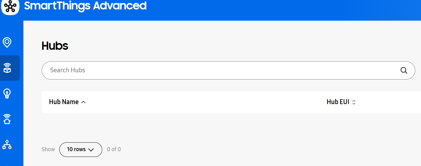

Hi everyone and hope I can find a solution to this issue. I had my main Smartthings WIFI, ET-WV525, hub go bad so I took one of the sub hubs and did a factory reset to convert it to be the a hub. After the factory reset I uninstalled my smartthings app and reinstalled it then I rebooted the hub and when I login to the app and go to the “Use Smartthings Hub” section and try to turn it on it just flips back to off. I tried this with the another ET-WV525 hub as well and got the same result. I also tried to uninstall and reinstall the app from my Galaxy Tab but got the same result. I have several linked devices, using zigbee, and Zwave as well as I’m using edge driver so need to get the hub function working. Any help would be much appreciated. I’ve opened several support cases and with no luck as they keep telling to do the steps I’ve already done several times.
