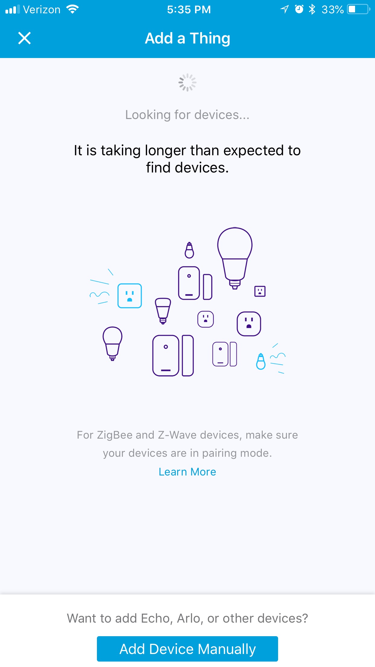

I reset the bulbs, got the bulb to flash five times. It appears that the beginning of the pairing process starts as the bulb will flash three more times, but then I never get the confirmation page that pairing was successful and the application never asks to name the bulb. I get this screen almost immediately after the three flashes (the part that says ‘it is taking longer than expected to find devices’ and image below)
