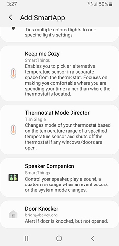

There is no custom section in the Add
Smartapp. This is the entire list in these 2 screen shots
Did you publish all 4 Smartapps in IDE and enable Oauth for the main webcore smartapp?
A screenshot of those in IDE will quickly show if you want to post. They show if they are published and true for Oauth. Don’t screenshot the entire page…just partial of the Smartapps for webcore.
I did publish all 4, and enabled Oauth. See below.

You were on the wrong shard.
You can use either the NA02 link or account.smartthings.com. Account will always redirect you to the correct shard which for you is NA02.
If you use the one you have bookmarked, it will not redirect you to your correct shard. Therefore, the code you installed will not be available in the ST app for you to use.
So, to fix… you will need to reinstall the smartapp code in the correct sh@rd. You may want to login to the other one first and remove the existing code so you don’t get confused in the future.
