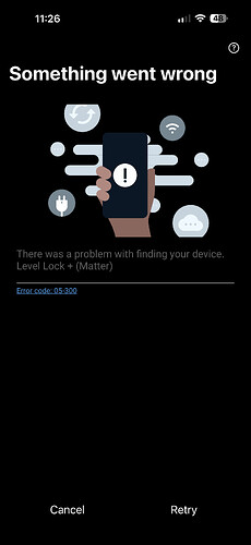

Hey all - I have been out of the game for a minute and recently bought a new house and am slowly rebuilding devices. I have a Samsung smart tv that supports matter and have successfully paired the lock with the level app but for the life of me I can’t get ST to see the lock. Anyone have success in doing this or suggestions to make this happen?

Thanks for the suggestions…my router is set to auto deploy IPv6 addresses, my smart tv is acting as the controller and I have an iPhone with the ST app working as the commissioner. I have rebooted the TV, the router, the lock and my phone several times, I am connecting (or attempting to) within 15 minutes of the chime after reboot and still the image below is what I’m getting.
