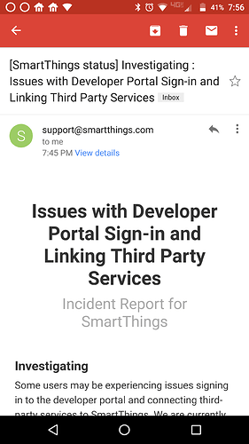

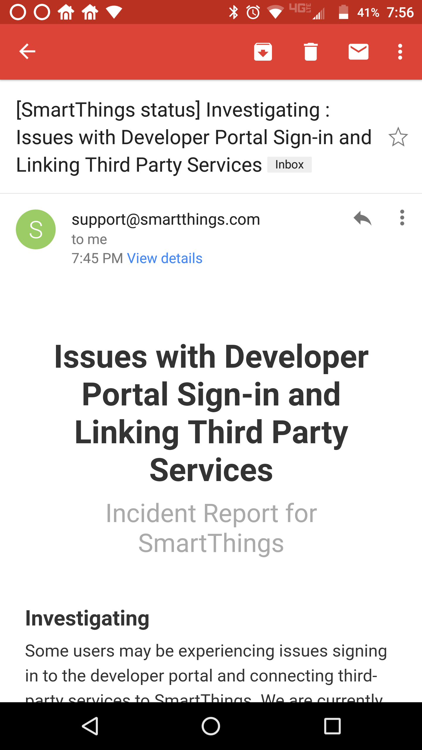

and no sooner than mentioning stability and reliability, this email comes across for ST:
