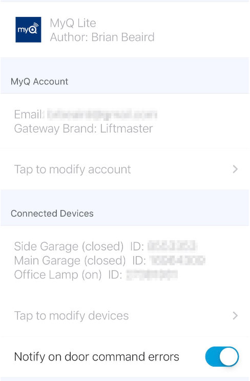

Important - After installing the newest SmartApp and Device Handler code, please open the SmartApp in the SmartThings Classic mobile app, tap on “modify devices”, and step through the device selection steps. The new version of the app should be smart enough to pick up your existing devices without affecting them. If that is not the case, let me know.
I was able to update via the IDE by updating my existing Github link from the ‘master’ branch to the ‘v3’ branch. After that, installed the updated code just like always. After that, from the Classic app, I went into the SmartApp and then saved, but that wasn’t enough to get things working. I had to tap on ‘Modify devices’ and step through that before things started working. Other than that, everything seems to be working the same as it did before.

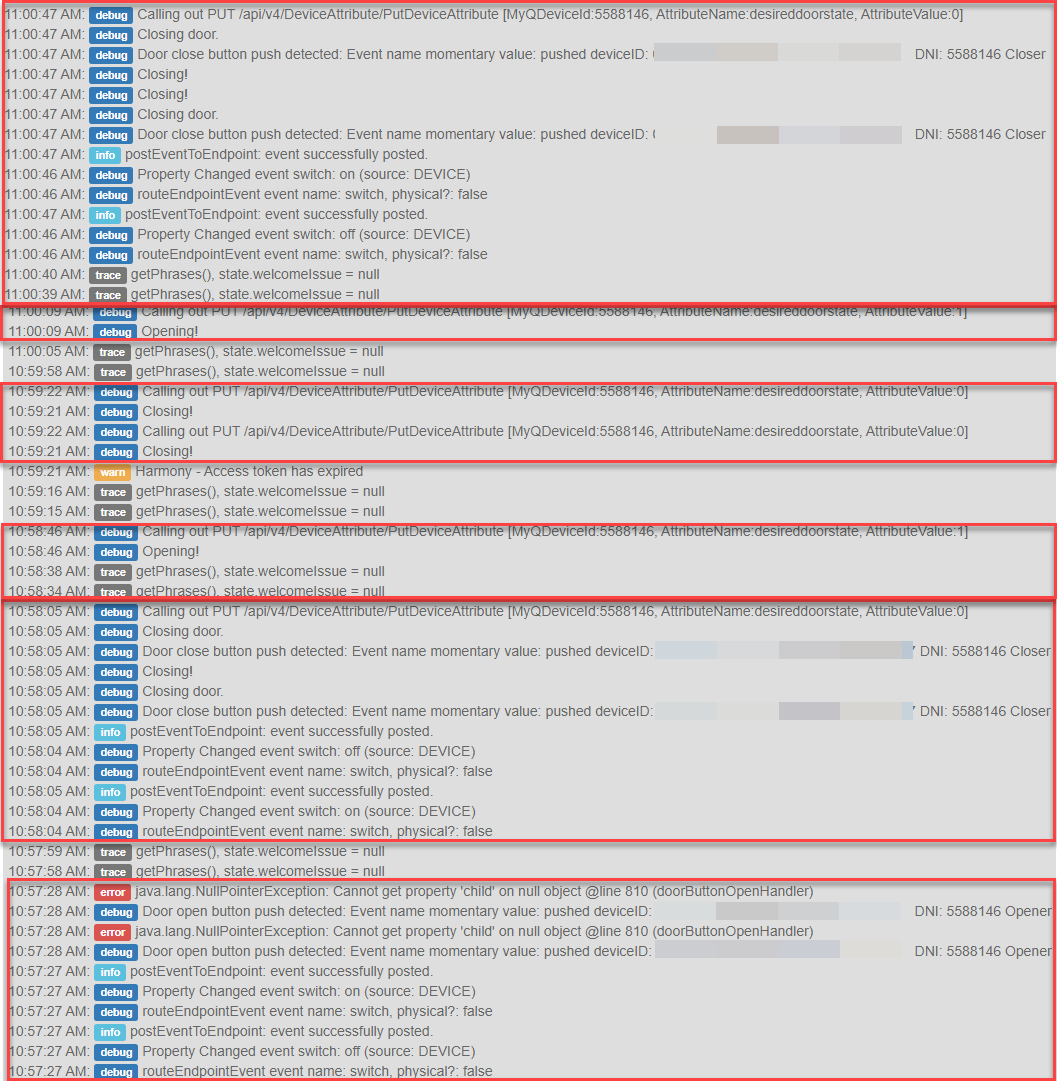

Thanks for the code! I installed 3.0 on a liftmaster myQ no sensors and I have everything set up and published. The momentary button tile doesnt seem to be working. I can click into the “Garage Door” option and open and close does work, but “Garage Door Open’ and Garage Door Close” buttons do not work. Again, these are all published and I can verify that the Door is assigned and I did the tap to modify option. Am I missing something? BTW Im able to see the buttons in the smartthings app.
Starting from the bottom here is the live logging.
-Open Door momentary Button pressed ( error nothing happens)
-Closed Door momentary Button pressed (no errors)
-Opened Door device (not button) and selected open (Door opens)
-Opened Door device (not button) and selected close (Door closes)
Testing Close Momentary Button Tile Event
-Closed Door momentary Button pressed (Door closes)
Not sure why the open event works for the device and not the button.
I did notice that the device ID for open and close are different. Not sure if that matters. I deleted everything and readded and i’m still see the dame results.
