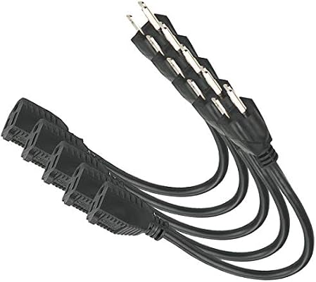

Not sure, but you can fit them with this!
Those are pretty nifty. My toaster wants one! Seriously I’m not sure if I’d like the outlet dangling in the air in a totally inaccessible spot. If I unload the entire cabinet next to the appliances (fairly easy, it only has household cleaning crap in it) and remove the earth quake straps, I think I can move it — it’s a heavier than it needs to be particle board 8 ft tall storage unit with two doors. If it’s empty I can drag it out from in front of the outlet. But I’m thinking something that attaches to the washer and dryer magnetically would be more practical. I’m not adverse to a battery operated sensor if I don’t need to hire a wrecking crew to replace the batteries. There are 2 in of clearance between the right side of the cabinet and the washer dryer stack. There is about 1ft on the other side, but the water connections are such that the washer can’t move another inch. The power cords plug in behind the cabinet. If I ever had to reset the outlet I’d be in a world of hurt because it would literally take a day to move that storage unit. I’ve one of the ST outlets powering my under cabinet light strips in my kitchen and I’ve had to reset it a couple times. I’d just as soon not use WiFi for this setup.
