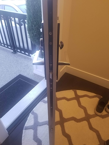

I recently moved and I am gutted that I cannot seem to find a smart lock that will work in my new house on the front door. Apparently it is some sort of new very secure door lock system and the few companies I have contacted said that their lock is not compatible. A lot of people here think out of the box so after looking at the pics I posted does anyone have the same door lock and have found something that works?

Second, is that a mortise lock of the kind that you have to slightly lift up to engage the bolt? If so, smart locks can’t work with it.
Third, that Turnbolt is quite an unusual shape, I’m not sure it would work with the usual retrofit locks like a Nuki.

But from your pictures is not clear that is the lock only at the middle of the door, or is it extended from top to bottom with additional latches to lock it. If top to bottom then the Doorman might not the right one.
Thanks. pretty sure that will not work. I have been digging more into it now and the type of lock system is called multilock and the brand is GU. Basically it has a rectangle bolt/latch that is opened up by a knob on the inside and key outside. Once the door is unlocked the handle is pushed down to open the door which release’s two additional bolt/latchs. So basically all the smart lock needs to do is be able to turn the main rectangular bolt to lock or unlock. Seems simple but can’t seem to find fit. More pictures below.
Multilocks usually require the handle to be lifted up before locking the door by key, to lock those additional two latches.
Maybe not a multilock then as I just open and close the door like any other normal door. No lifting, or pushing needed?
Then your best option is probably the Nuki, if that could turn the deadbolt’s square shaft, if the deabolt can be removed. As @JDRoberts suggested.

I started this awhile ago looking for some help and forgot to post my solution in case anyone else runs into the same issue. I stumbled across a smart lock company called Candy House https://candyhouse.co/. the lock is called Sesame Lock.
The were an amazing company to work with. I sent them my issue, they asked for photos and measurements and in return they sent me a free 3d printer drawing for an adaptor that made their lock work for me. Super easy to get done. The lock and software itself are great. I just have not integrated it with Smartthings yet but am working on it. Highly recommend the product and the company.
