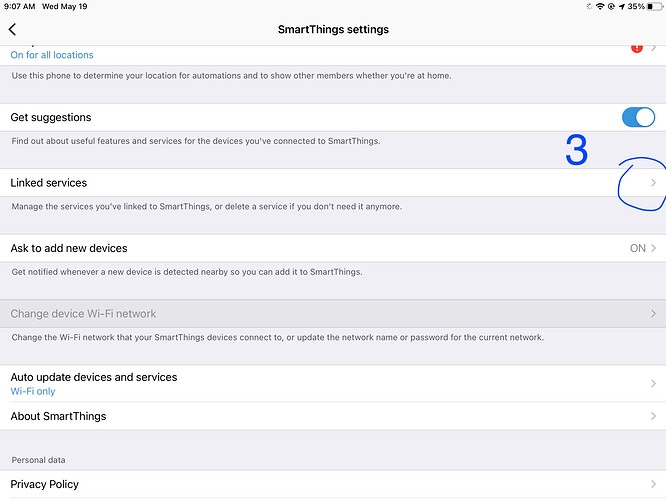

It’s in the smartthings app, but you have to make a connection at the account level between your SmartThings account and your ring account. Then that should pull in any eligible devices from your Ring account so they show up in your smartthings app. that’s why sometimes when they add new devices to the integration you sometimes have to log out of the account level integration and log back in in order to get the new devices to show up.
There’s probably more than one way to get to your linked services, but this is how I do it.
  1. Tap on the three horizontal line icon in the upper left of the main screen.
  1. Choose settings, which is the little gear icon in the upper right of the pop-up:
  1. Find “ linked services“ and tap on the action icon on that line:

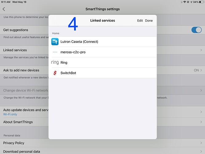

  1. This will bring up the list of services that you have linked at the account level to your account. So when you select one of those, you will be able to unlink it.
I can’t remember if you can link it again from there, if not, just try to add any device from that service and you should be given the sign-in screens again.
@Automated_House
JD has it right. Settings> linked services and delete the old ring integration. Then + menu and add ring again.
