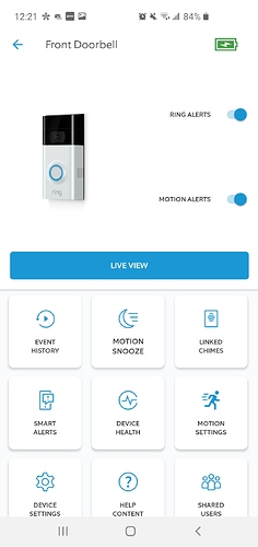

Live view:
Just change DTH to Pro
I have doorbell 2
