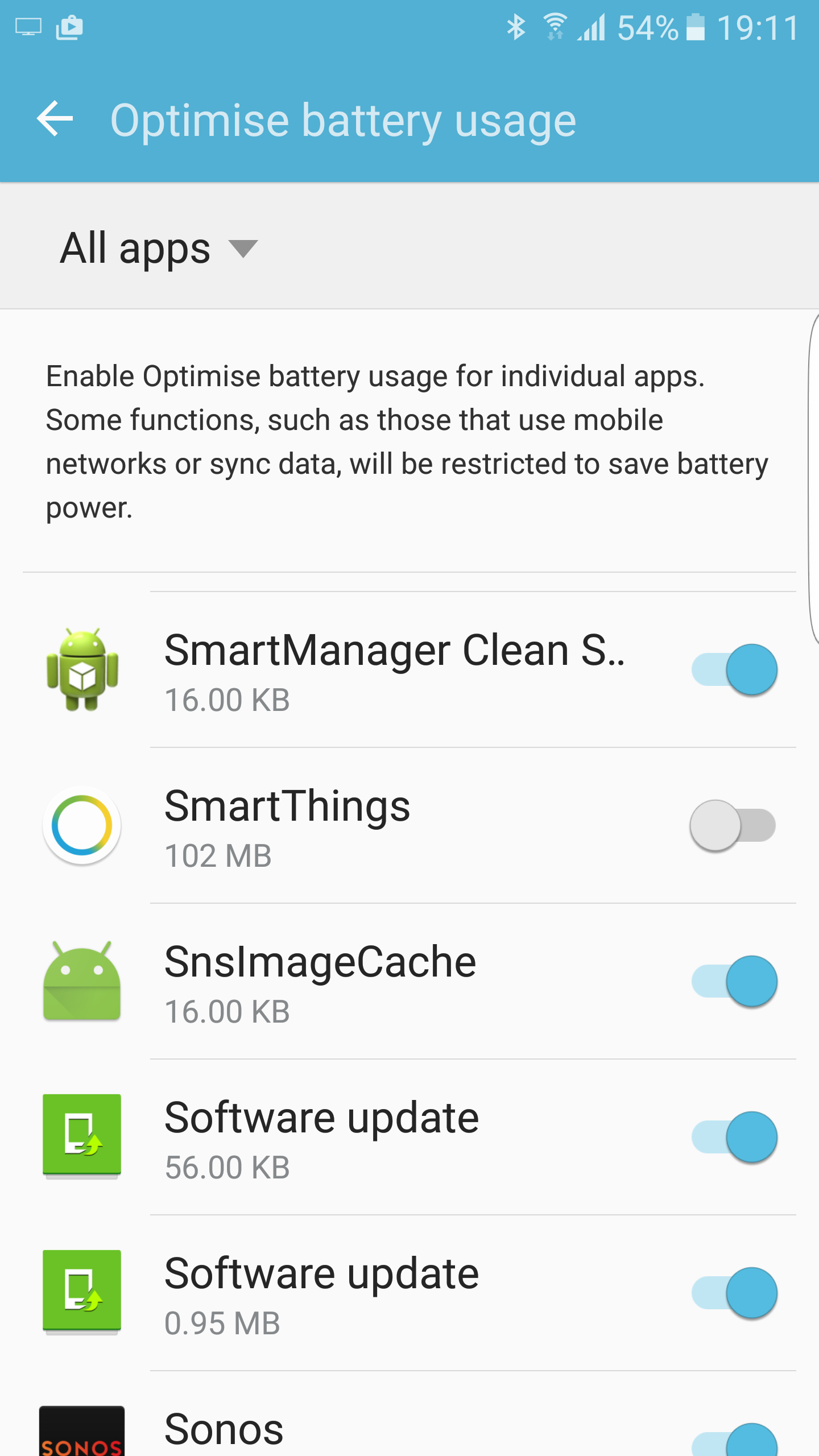

There is a way to exclude specific applications from Doze. I’m running M and have been for a while. My alarm goes off every day, no problem. I also get ST notifications as I have excluded ST from Doze.

Thanks Guys. John I’ve tried this already and it doesn’t work for me. It seems developers must code for Doze possibly to allow exclusion - I’ll do some more reading to check.

I have “Don’t Optimize” and my phone still goes to sleep at night even while plugged in. I have a Axon Pro, and I think one issue with my phone is that once it is 100% charged it changes its state to Not Charging. Any app that looks for a charging state will not run even though it is still plugged in.
Ok. John is suggesting that you select “Don’t optimize” for the SmartThings App. So if your phone goes into the Doze state the SmartThings app will ignore Doze and still send notifications etc. I have tested this and it doesn’t seem to work for me so I am re-testing! I’ll report back…
I agree, I already had “Don’t optimize” selected, and it still didn’t work. I’ve set the notifications to priority and I’ve set llama to turn on the wifi every 5 minutes all night to try and keep the phone awake. I’ll see if it makes any difference.

Thanks for the updates. I think the SmartThings developers need to code for the “Don’t optimize” to work correctly but I’ll let you know what my findings are. I would have thought that this would be a major issue for many people but after Googling I can’t seem to find anything on it (hence my posting).

Thanks Darren. Could you elaborate a little more please? Have you added SmartThings to the Don’t optimize list? I get all notifications perfect each and every time too, the problem however occurs when phone is in Doze state (left on desk for a period of time, when I go to sleep etc). The notifications only reach the phone when it is picked up i.e. comes out of Doze state. Have you checked this?

I took it off the optimisation list. I also added an exception to dnd. My house goes into alarmed home state at 11:00 and my phone is on the wireless charger from about it 10. If I open the door to pop outside the notification comes through straight away.
Samsung has changed interface slightly but I don’t think manufactureres are allow to fiddle with the Doze code so it should be consistent. As siuenger mentioned above if phone is charging Doze doesn’t enable so that could be why you are receiving notifications immediately - I’m having hassles when phone is not charging!
