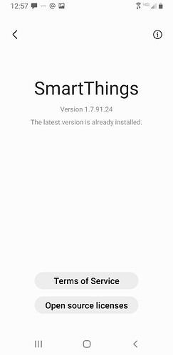

Probably completely un related but version 1.7.91.24 of the Android app does lock up for me on an S10
Usually when a device control page is open and i minimise the app to use the phone for another purpose, maximising the minimised ST page previously open just results in a blank black screen, trying to go back using the back button has no affect and i have to force close the ST app

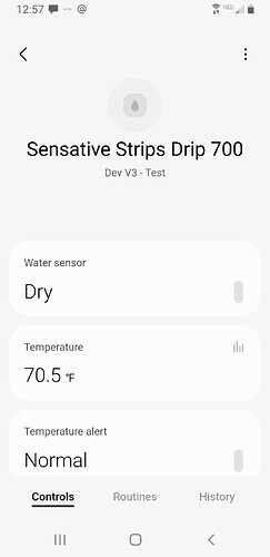

I did some more testing this morning and am seeing slightly different results. When I switch back and forth to the 700 series driver, the app no longer blanks out. Instead the app crashes when I switch to the 700 driver. Restarting the app, other devices all appear fine. The drip strip is still inaccessible. Switching back to the non-provisioned ST driver makes the device accessible, although non functional.

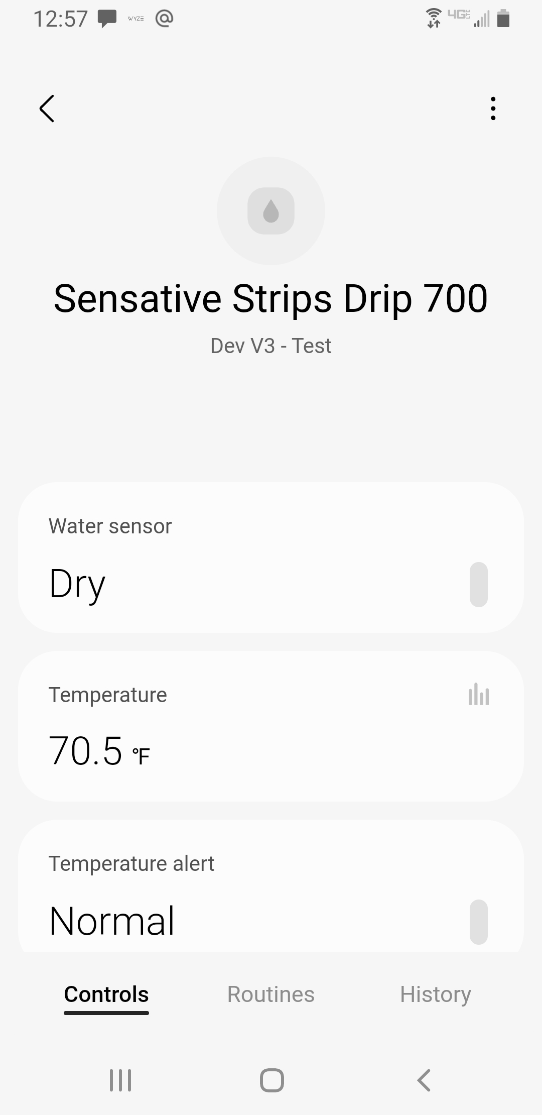

I just realized my device was using the version from my dev channel and not the official channel and when I switched it to the official one I’m seeing the latest behavior you are with the Drips 700 and Comfort 700.
I haven’t released a new version of mine so I have no clue why mine is working and theirs isn’t, unless this issue only applies to recently joined devices. If it only happens when switching to the driver or joining a new device then that would explain why no one else is reporting the problem.
I’m curious to see if it starts working again once I switch it back tot the one from my channel, but how are you changing the driver without opening the device?

The Comfort starting working as soon as I removed the Drips and it continued working after I added the vid back to that profile so you’re right about the issue being specific to the Drips.
I added the Drips back and everything is working again so I’m thinking the issue probably has something to do with the Drips device-config and since the default presentation works OK for this device I sent Sensative a new version that doesn’t use a custom presentation for it.
