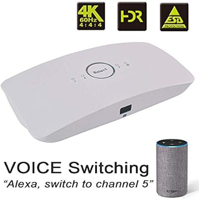

I have had an issue where a new hdmi switch put down all my Zigbee network. The device was the following:
Just initiated the return.
