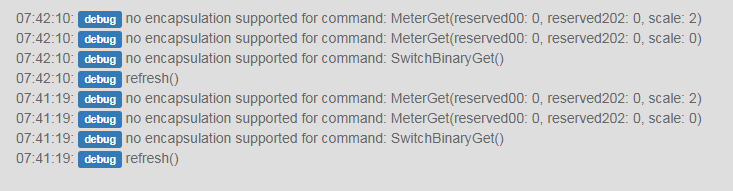

just looked at mine and all the 3 devices using Z-Wave Metering Switch have the same debug message, they all seam to be responding to commands in the app though
Same “debug” message, but not the same error message:
