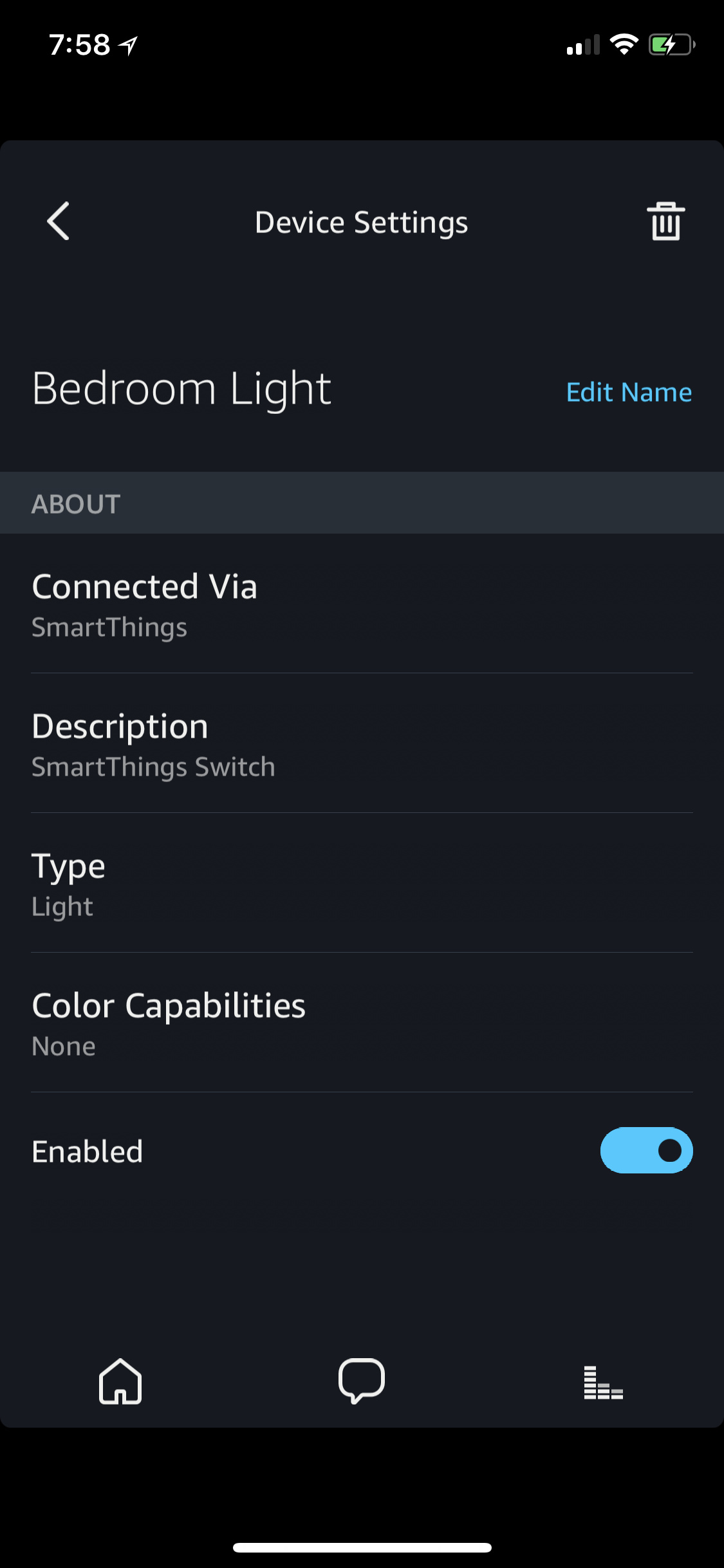

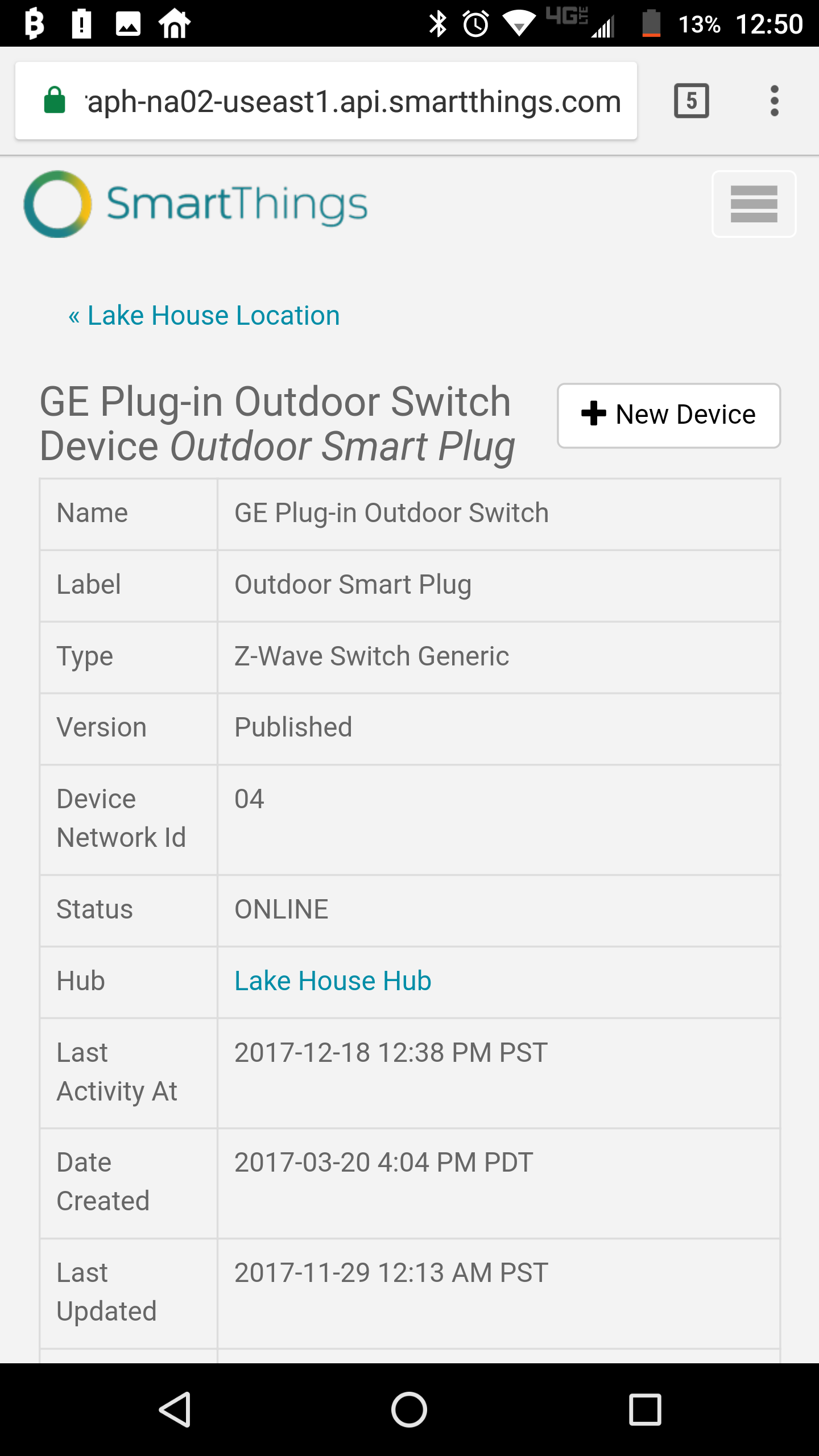

When you edit the Device in Alexa,what does it show? I have a GE Smart Plug outside. I just added it to Alexa and she responded fine to it.
I know we are talking about different devices, but maybe it has something to do with how Alexa is recognizing it. Here is the device type being used by my GE Z-Wave Smart Plug / Module. Or a new Alexa issue :slight_smile:
Yeah I don’t get it. This thing has worked fine for 6+ months and all of the sudden this one device starts acting odd within Alexa.
