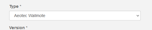

Edit the device in the IDE and double-check to ensure the “Type” is Aeotec Wallmote.
Thanks for the reply! Upon checking it does say that it is a aeotec wallmote. I reached out to aeotec supportt and they confirmed that they are seeing the same issue currently, at least for some of their employees.
