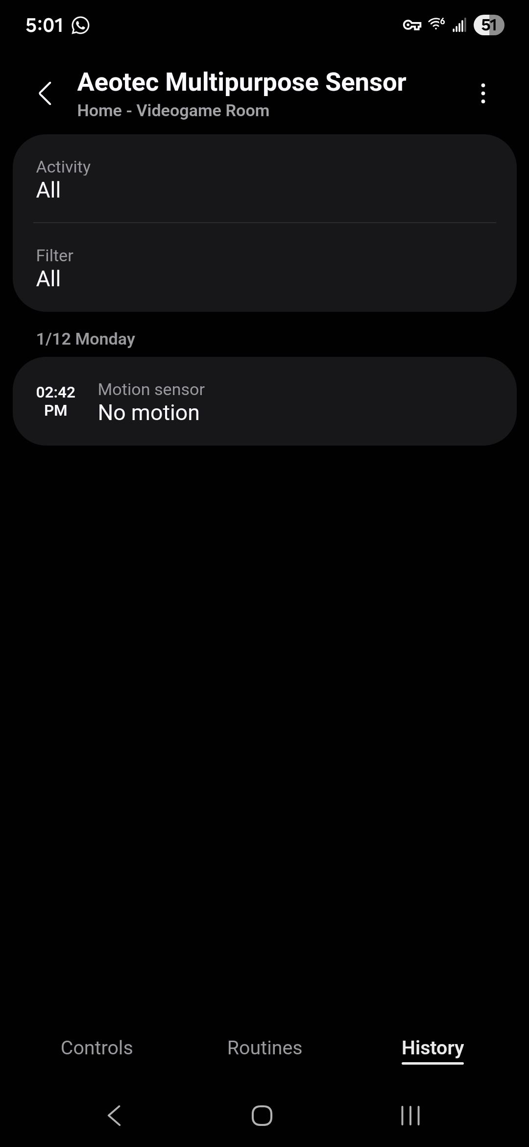

Here is an example of a Z-wave device that sent one event yesterday (for the first time in weeks) and then went offline.
Could you please try removing and re-adding a few of the affected devices (starting with some of the battery-powered ā€œsleepyā€ Z-Wave ones) and let us know if you see any improvement after doing so?
This will help us understand whether re-pairing resolves the issue in your environment before suggesting it for all devices.
