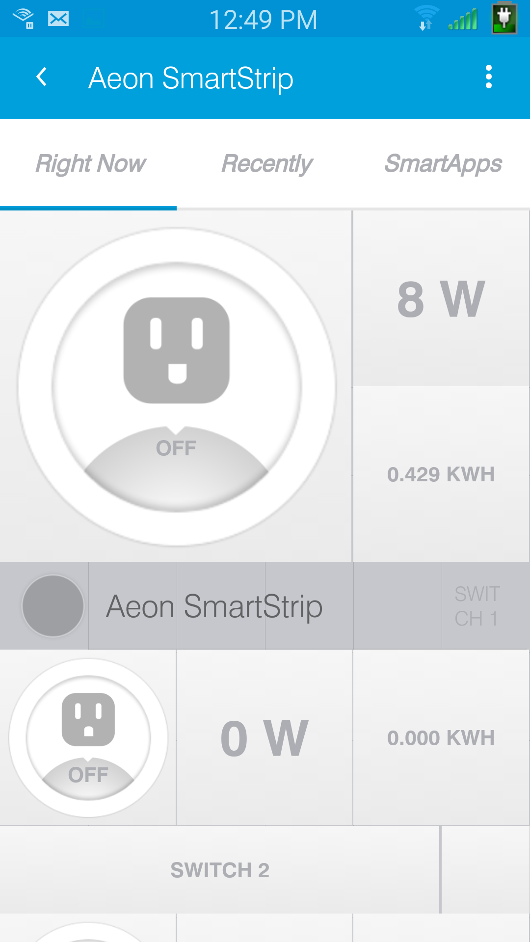

as mentioned above, I would like to be able to make the label the full width but here is a bug in the andoid app version. When I make the labels to be width 6 it looks like this
In addition, at least on android you will have to use version 2.0.7 ( the last version) as version 2.0.8 screws up alignment, color and text when part of the device type comes up below the fold. I have reported this issue and they know about it. Maybe I will attempt to fix it again when version 2.0.9 comes out.
I modified cooperlee version with labels for each outlet, but still had the two unswitchable outlets listed since I like to see their power usage as well. Your version with the two outlets and overall power, sw7 I believe, would be optimal, is that something you can make option to display in the edit options for it or something? And yes using 2.08 on Android is horrible. But I need the ability to organize devices in rooms over it looking pretty.
