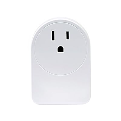

I received the engineering spec from my friends at Aeotec, so I was able to write a functional device type for the Aeon Labs Z-Wave Smart Energy Switch . I know @bmmiller has already written a device type for this but included some preference that people might find useful.
This device type remains ACTIVE so no need to poll the device from a SmartApp to keep it reporting
You can disable the remote switch if you only care about energy monitoring
You can adjust the interval that device reports to the SmartThings hub
You can adjust in the preferences how the switch responds to the “Switch All” command
You can turn on/off the debugging for the device though the UI
I also commented all of the possible configuration values in the code if someone wants to subvert the device to their own will.
