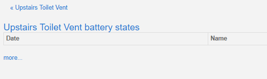

Perhaps. SmartThings will not update if the previous value is exactly the same as what was just sent from the device. If the device keeps sending 0’s, then the only one that will be “recorded” will be the first 0 until it changes. It’s the same way battery powered devices work. They may send their value every hour, but ST won’t update until it changes. You’ll see that in the IDE if you specifically look at the current state for a device’s battery capability. Since logs are only kept for 7 days, you’ll likely see an empty event log for battery readings:
