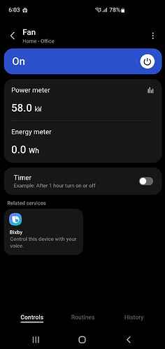

sorry for late reply , i noticed today that devices started to shows power read , however there is something wrong with matter electric its like inverted , I attach for you some screenshots and let me know if you needed any further info’s .
What do you mean inverted?
In the Advanced Users app I see power Meter reports 60000 Watts and the app shows 58 Kilowatts, so the difference is because of the unit, did you take both captures at the same time? if that was the case, the app should show 60 kW
And, the energy Meter capability shows correctly 0 in both, in this case, the unit is the same, so, both should show the same value.
ok i made two new screenshots at same time for same read
as you see in the screenshot the power read was 60000 watts and the app shows 60 kilowatts for the same device while energy remain 0 until now , to clear my issue this device is a small fan connected to plug over z2m and the actual power should be 60 watt only not kilowatts , and accumulated energy is 214.14 k , I will attach below screenshot for the device power read
its true that smartthings showing same value between advanced user page and app because both for smartthings , but reading from source has to be reviewed because not matching , if you needed any more info or tests I’m ready to help
@nayelyz I believe there is indeed a bug in the Matter switch driver.
Matter reports the active power in mW per specification, but the raw value is passed to the powerMeter capability as if they were watts, hence that SmartThings thinks the device is reporting 60000 W when it should be 60000 mW / 1000 = 60 W.
