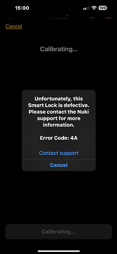

Well. Its dead now
Totally unresponsive. Less than 2 years old and the motor has died. Good job i got the guarantee plus.
They asked for my invoice again!! :rofl:
