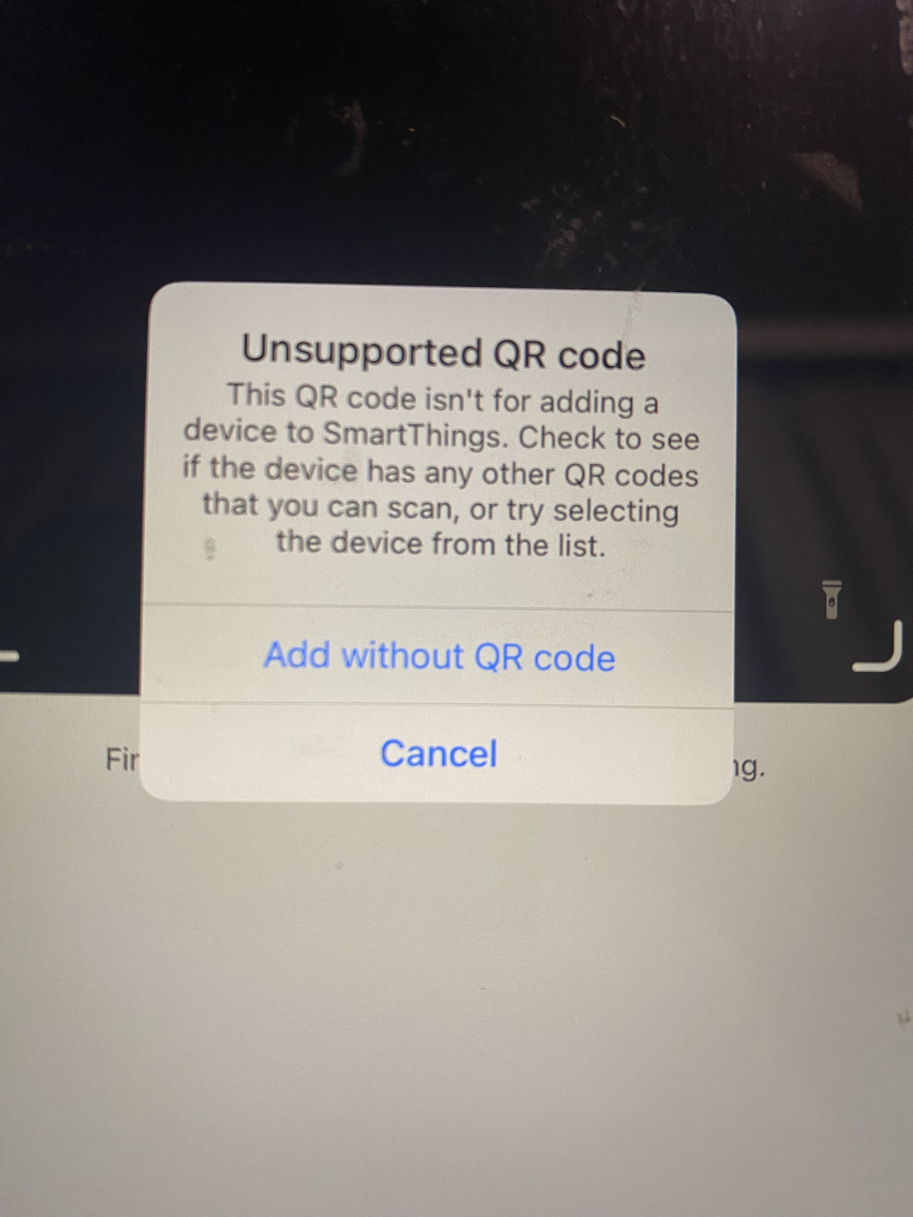

What is odd to me is that if you add the zemismart hub to smarthings directly via QR it will add just fine as a bridge. But you can not do anything with it or add devices to it.
If you add it to tuya first then try to share as matter gateway then smarthings does not recognize the QR code as a device it can add.

One more thought… A lot of people have gotten tripped up because they selected “scan QR code“ before selecting “matter“.”
I personally think it’s a pretty confusing UI, but it is what it is.
  1. Start by choosing “partner devices/matter“.
Do not start by choosing “scan QR code“ or it won’t work.
  1. On the next screen, choose “matter” from the top
Do not choose the brand name of the device.
  1. Now you will finally get a screen where you can say you want to scan the matter pairing code.
Again, before starting these three steps, you have to add the matter bridge to its own app, select the end devices you want to bridge, and generate a matter pairing code for the bridge.
If you’re already doing the steps in the sequence, and it’s still not working, then you may have to get in touch with zemiSmart support.
if by chance you’ve been starting with the “scan QR“ code step instead of starting with the matter selection, try the process I’ve just detailed and see if it works. And know that you are not alone if that’s the issue; it’s tripped up many people. :face_with_raised_eyebrow:
