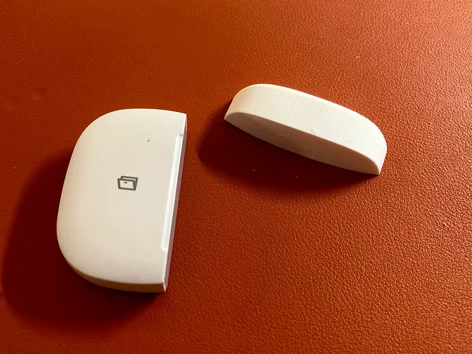

Although, the icon is similar to a contact sensor. I think the icon of “motion sensor” fits better, when the status in the dashboard is “active” the icon jolts and shows those lines in red.

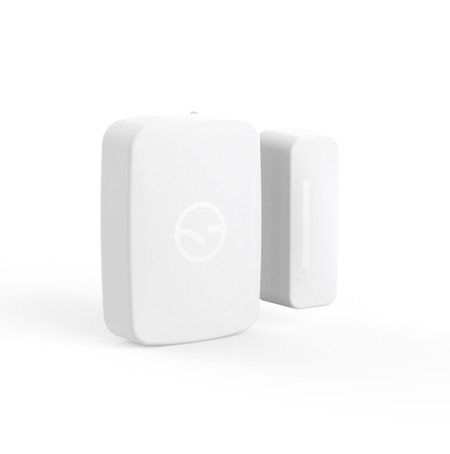

Pretty sure the artist based it on the SmartThings brand multi sensor, which is very unusual in being a contact sensor as well as an accelerometer. ( it may have been designed for a garage door use case.)
Valid, but so is your argument. Basically once you have a class for “multisensor“ it’s hard to pick the right icon. I mean, what do you do with this one?
