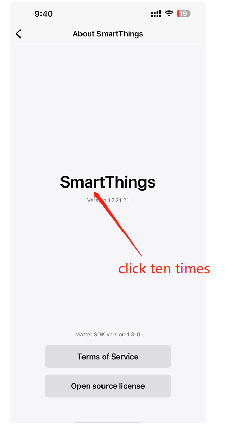

If you click on ‘About SmartThings’ you get a page with a bold ‘SmartThings’ title. Clicking on that ten times opens the ‘SMARTTHINGS TEST MODE’ page. Support have been known to ask users to open that page in order to use the ‘Report a problem’ option, which makes you wonder why they went to such lengths to hide it.

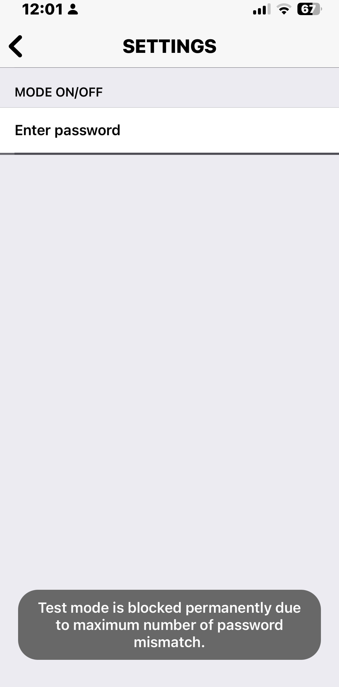

After click the “SmartThings” title for ten times, it always open a page to ask for a password, is this the correct trigger mothod to enable test mode?
When you want to test devices or apps in SmartThings it is the ‘developer mode’ that you need to enable. For that you hold down the ‘About SmartThings’ link in the app settings menu for several seconds. That’s the link you clicked to get to the page you showed. A ‘Developer options’ section should appear but as it is added to the page after the link you are holding you might not notice until you let go and scroll down the page.

On iOS (1.7.21.21) the resulting screen is this, with no option to select. In my case if I touch the password box I’ll get the message below as I’ve been through this several times.
Support have not been able to help as after going through form/phone call /referred to apps department the end result is a mail (translated from Spanish)
“In relation to your query about the developer mode in SmartThings, this mode is offered only as a way to verify the developers themselves and is not open nor can it be disclosed externally.
We apologize for the inconvenience.”
This cannot be replied, so back to "square 1.":man_shrugging:

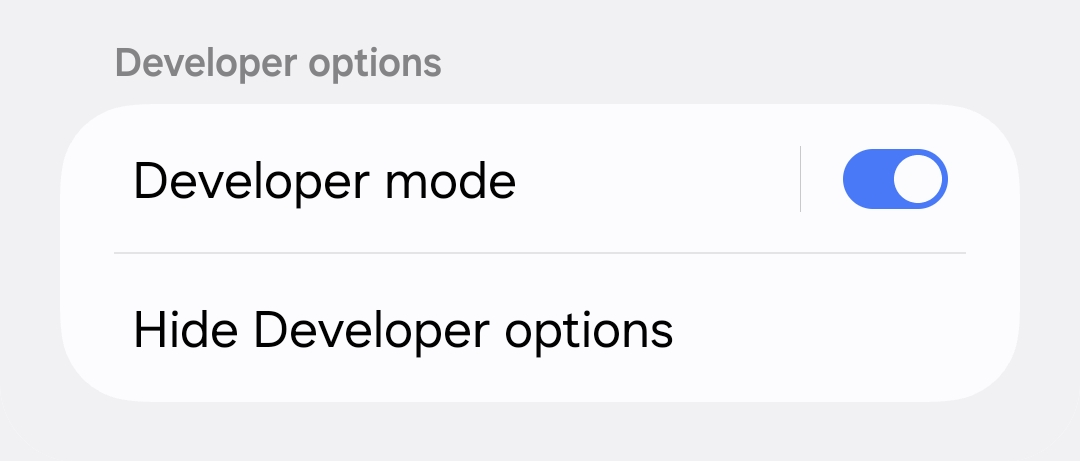

What changes in the app with the developer mode active?
When you hold down the ‘About SmartThings’ link for five seconds you are enabling the Developer options menu. It is very much like enabling developer options in Android.
Toggling Developer mode restarts the app as well as toggling the mode. You can click on the text of the toggle and you’ll see an option to restart the app plus your developer ID, which you may recognise as a combination of your four letter manufacturerId and the four letter code for your organisation in the Developer Workspace. All very Samsung in style but of course it is a Samsung app.
If you have created SmartApps in the Developer Workspace and have ‘published them to test’, enabling Developer Mode makes these SmartApps available in the Discover menu on the Routines page from were you can install them.
If you are creating devices via the Developer Workspace you should also see a My testing devices (or similar) ‘brand’ when you go to add a device. Unfortunately the ability to create projects for SmartApp powered devices has vanished from the Developer Workspace and there now doesn’t seem to be any way to see My testing devices if that is the only sort of device you have. This is why I am vague about the name. They only seem to care about the ‘schema’ approach to cloud devices these days.
Clearly they are confusing ‘Developer mode’, which is an end user option, with ‘Test mode’ which is for the mobile app developers. Two different things. Your screenshot shows ‘Test mode’.

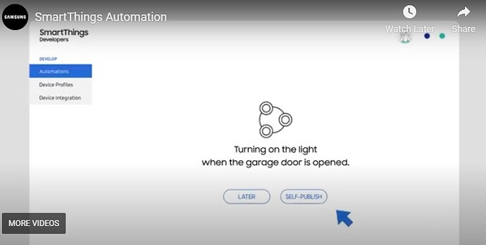

as my initial interest in activating this mode was for trying out a self -use automation using Samsung Automation Studio.
I can get on with this as it is a clone of Node-red which I am using increasingly - is this no longer possible?
The Developer Workspace still supports the creation of Webhook SmartApps as automations, which is probably what you want.
If you want to create cloud to cloud devices you are supposed to be able to choose between using the Schema (which creates VIPER devices) or using a SmartApp (APP devices). However support for the latter for cloud devices completely vanished from the Developer Workspace some time ago and last time I checked only the Developer Workspace possessed the secret sauce to plumb SmartApps into the mobile app. You can do everything else using the SmartThings API, but the mobile app is from planet Samsung and they do things differently.
